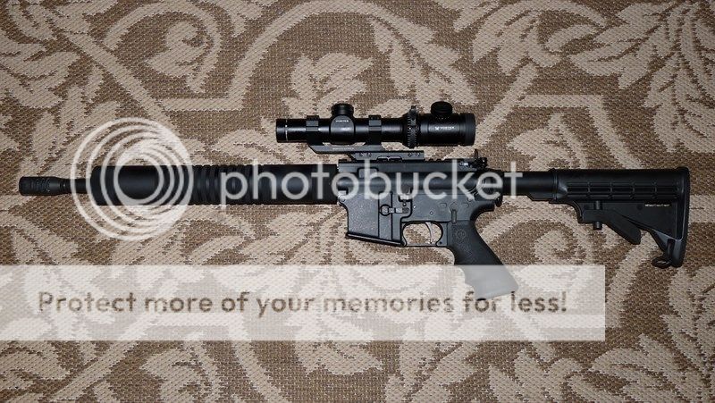

    Since my last range report I installed a Timney trigger and a Hoque 12.5" handguard.
    I cut the front sight off the gasblock and it fits nicely under the new hand guard.
    The Timney trigger is an awesome upgrade compared to the stock trigger. I bought the 3 lb model and mine breaks at 3lb 8oz. Very clean break with no creep whatsoever and little overtravel. The reset is very short. Love it!!!
    No feeding or other malfunctions since the last report.

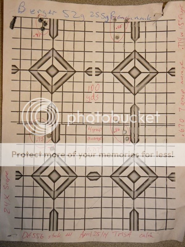

    I made a few handloads and put a 6x24 power scope on it to see how well this gun might group. I tried some 55g Hornady FMJBT with Varget and with Benchmark. Also some 52g Berger FB Varmint with the same two powders.
    All groups were shot at 100 yds and the wind was fairly calm.

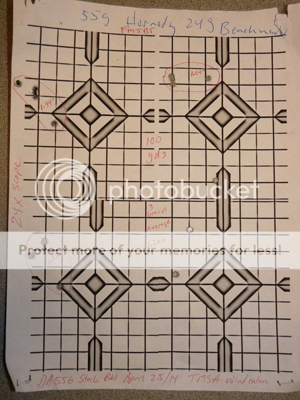

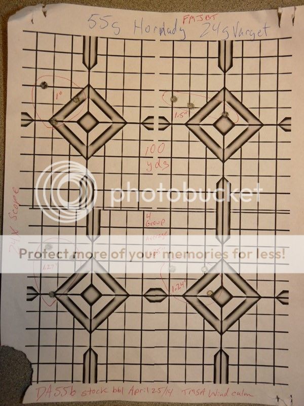

    The Hornady 55g FMJBT 3 shot groups averaged 1.25" with both powders with the smallest group being 1" and the largest 1.5".

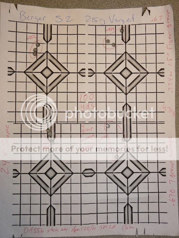

    The Berger 52g 3 shot groups averaged .717" with Benchmark and .834" with Varget. Out of 8, 3 shot groups with the Bergers I had one group that a flyer opened up to 1.5 ". Out of the other 7 groups the smallest was .41" and the largest .86".

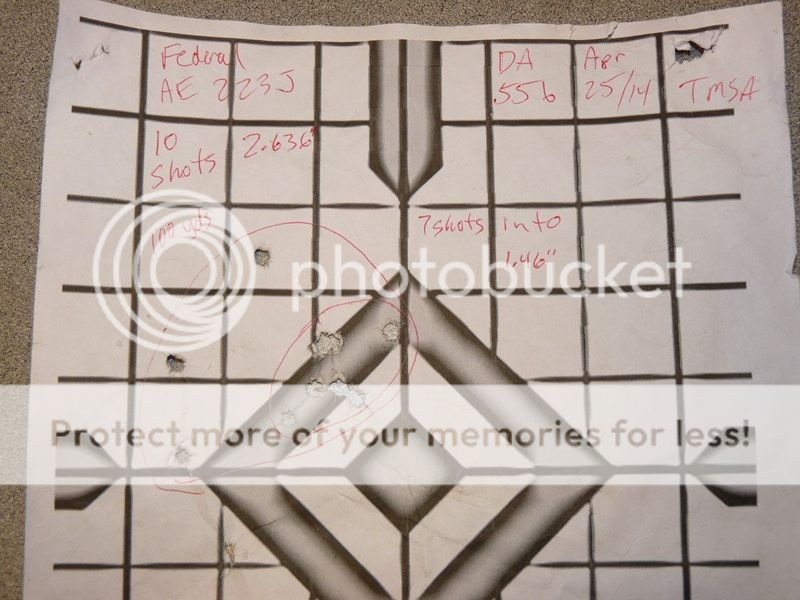

    Fired a quick 10 round mag of Federal Tactical AE233J at the end, and 7 of the ten shots went into 1.46" and 3 shots went wide and opened up the group to 2.636".

    Nice grouping on the 52gr Berger but isnt the 25.5gr benchmark exceed max pressure?

    Nope, their online load data site seems to be down right now but some data sheets I have show max 26.5 g Benchmark for 50 grainers and 25.6g for 55g

    What kind of hand guard is that? Looks good.

    Hogue 12.5"
