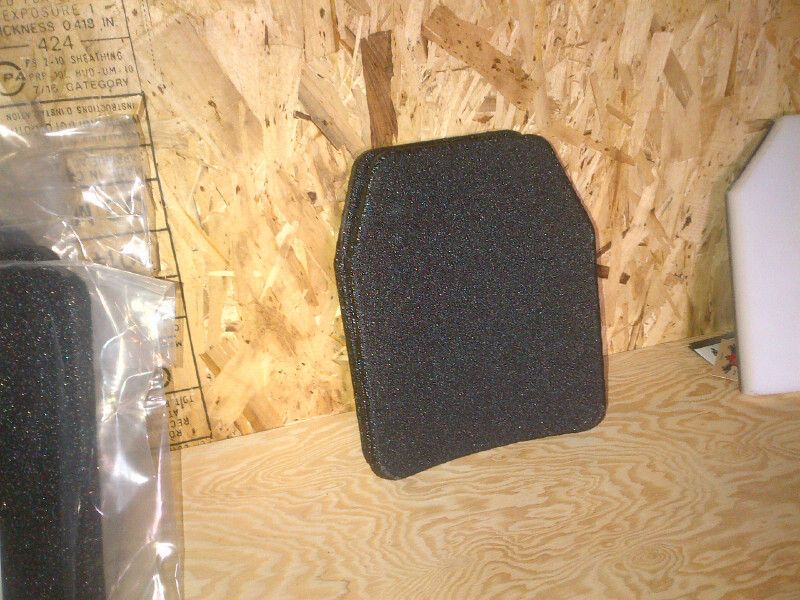

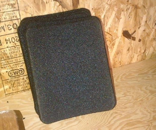

    Hi. I am totally new to plates. Can you telle the differences between non shooters and shooters cut plates, and their pros and cons? Maybe also add some pictures. I also have a vest but not sure which ones will fits.
    whats the difference between level 3 and 4?
    how long you can store them for emergency events?
    Thanks
  8. #18
    Business Member badboybeeson's Avatar
    Join Date
    Mar 2004
    East ontario
    Posts
    15,446
    Quote Originally Posted by bacardi View Post
    Thanks
    Yes pics are a bit lacking. Will get that fixed
    L3 will stop muti hit 223 and 308. X39. Etc
    L4 will stop 3006. X54 bigger hunting rounds like 300 win mag etc.
    They should last forever.
    Even if you treat then. Rough

    Whats the difference between shooters and non shooters cut?
  10. #20
    Join Date
    Oct 2009
    Posts
    1,067
    shooter : top is almost triangle....
    Non shooter : totally square
