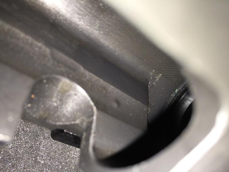

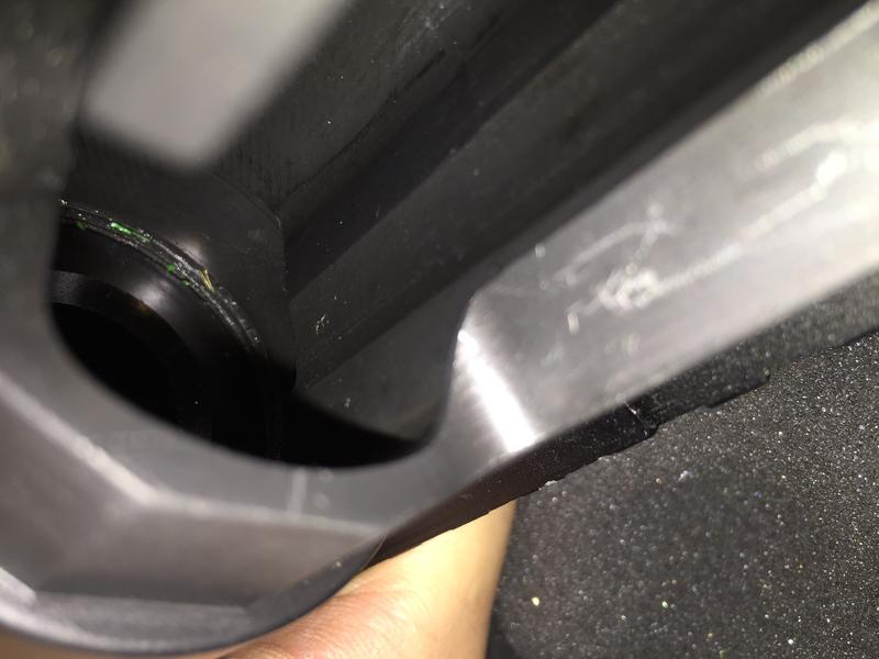

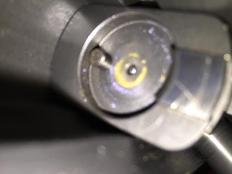

Size:  42.2 KBHello all. I picked up a DA 50 upper, and before some of you state you got what was coming to you, I fully lowered my expectations on the finish and machining marks with the price point this was being offered at. I expected something like a norinco. Looks like crap but bullet proof and with out thinking about it, safe.
    Saying that, I've purchased from Canada ammo before and have been very happy with the purchases. I guess chalk it up to being concerned a bit more with the larger round being chambered this time.
    But upon receiving it and performing a tear down inspection and cleaning, I couldn't help but noticing some concerns. I have a few questions for others who have bought the upper.
    1-Does your bolt lock up tight, or does it have some forward/backward slop? I have about 3-4mm travel or slop without a round in the chamber (I haven't received the ammo I ordered yet). Is this normal?
    2-Does your upper look like its been fired? Mine does, curious if its from the proof testing, a returned firearm which I don't believe it would be, or a initial tested upper? I have brass marks on the bolt face along with a purple ring, which I'm assuming is from the primer sealer. But looking over the upper, I cant find any proof marks striked. Any one else see this on their upper?
    3-Where the barrel shroud bolts onto the receiver, on the top and bottom with the two allen key cap screws, my receiver is dimpled from the ends of the cap screws or almost machined through the bolt channel. I know its not in the chamber where the pressures would cause concern, but I'm wondering what the hell this means for a safety factor. Does anyone else have these marks?
    I have no idea how to post pics up here, but if someone can enlighten me, I'm willing to learn!

    Hello my dear friend,
    I designed DA50 for CanadaAmmo.com. It has been a pleasure to work with this best firearm comapny in Canada. DA50 is a fine Canadian rifle. for exampel, the surface is Nitro coated. That's as good any coating can go. The same as HK or any big brand.
    Here I will try to answer your question:
    1, the gap - All firearm has it or we will have serious headspace problem. However, in a typical bolt action gun the firepin is in the bolt so spring push the bolt forward thus you won't feel it. DA50, however, is a hammer gun so you will feel it. Put a round in and try again. You will see the gap gone.
    2, Yes we test fired each of them so far.
    3, It's perfectly safe. The stength of the our receiver is at least 30 times over its requirment. I could have use aluminum to build it. However, that will create a very unbanlanced rifle because of the heavy barrel in the front. Plus, recoil will be too much even we have the best brake installed.

    Hey, great to hear your on here, makes this really easy to find out.
    So I've actually measured it after ive had some sleep. Please forgive my imperial to metric conversion late last night. It has an 1/8" play or slop on the entire bolt once the handle has been put down.
    Forgive my lack of knowledge in how one builds a firearm, but curious wise. Is it test fired once it's assembled by you, is it suppose to be proofed stamp from you guys, or is it mossbergs proof on the barrel good enough for all around?
    As far as the receiver, I still have to sign up to post a picture in relation to the dimples or such.
    I'm honestly stuck at work and had to sneak out to post this. If I can email the pictures to someone who can post them, I'd greatly appreciate it.
    I'll also send them to you Q
