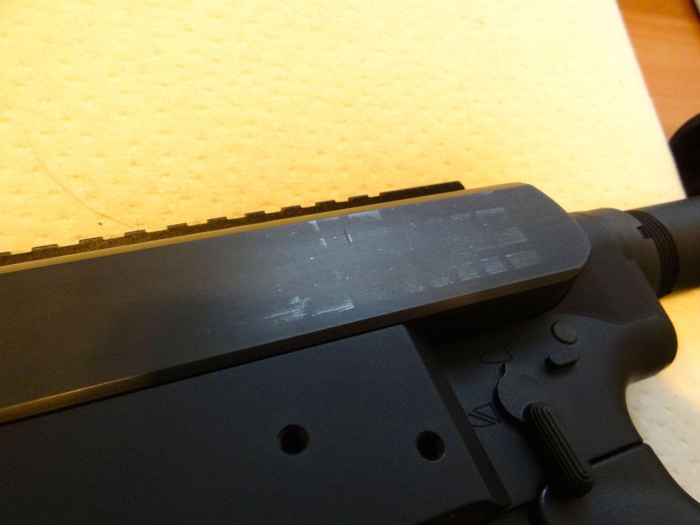

    Just got mine , looks good other than a few small issues . First theres a blemish on the side of my upper now clearly from a table vice? i dont mind superficial marks on guns i look at them as tools but come on guys this is the second rifle i have got back from you with new blemishes or dings , use some bloody leather or rubber on your vices . Other thing is the block welded onto the bottom of the upper still has a raw steel finish no bluing or guncoat even on it , looks very unfinished , also from the welding the finish on the inside of my action is discolored from the heat , maybe unavoidable?

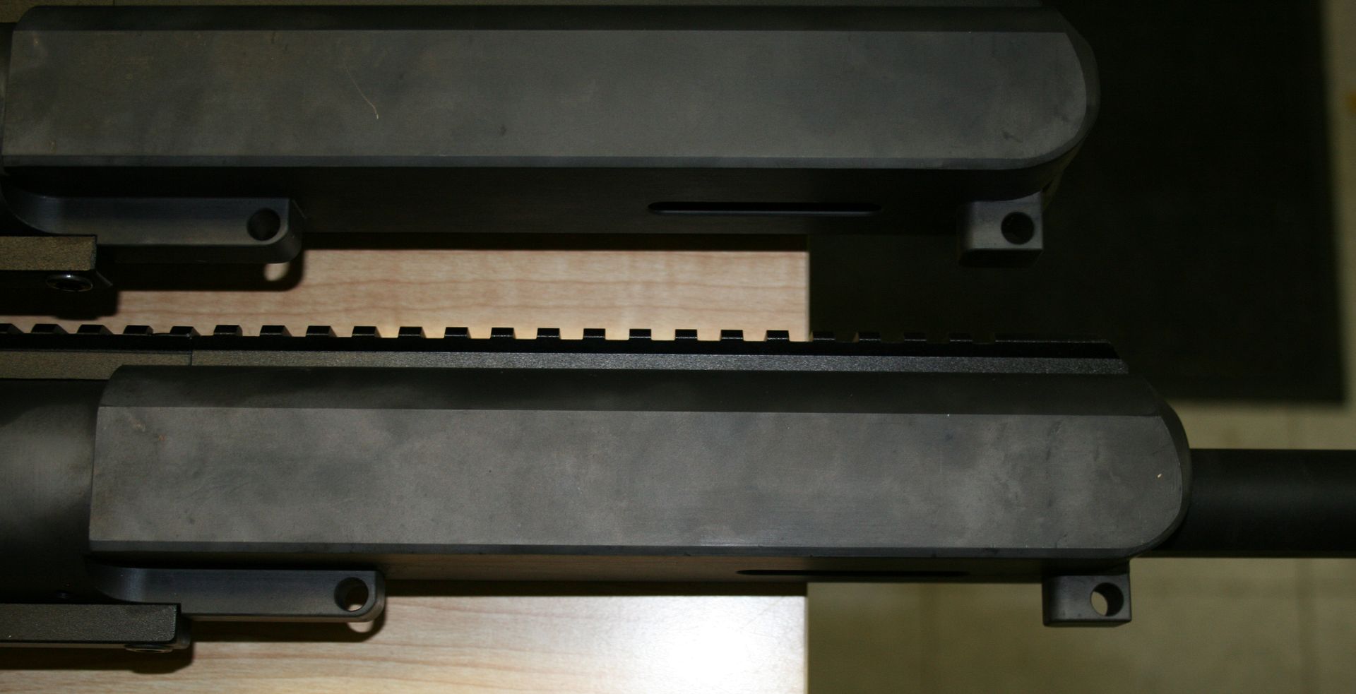

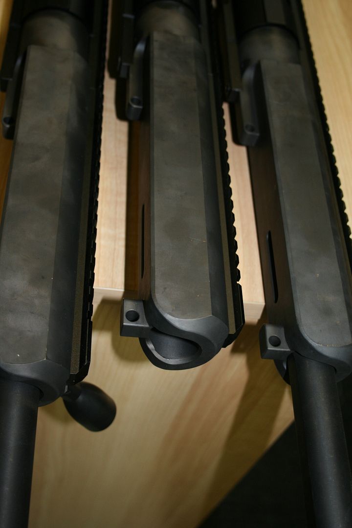

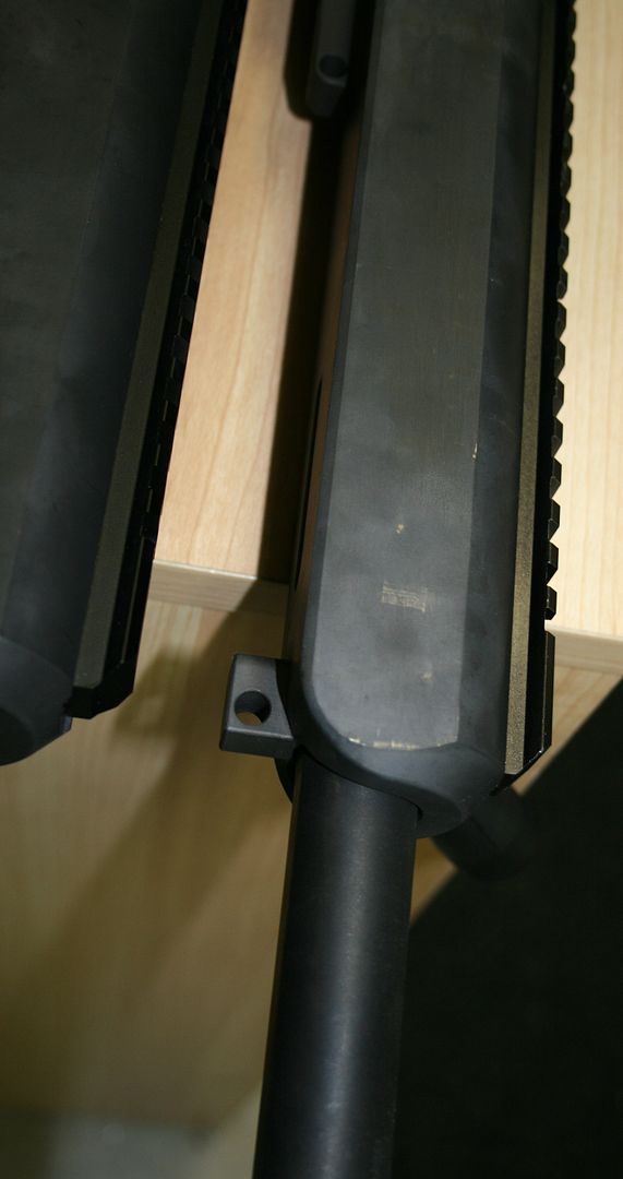

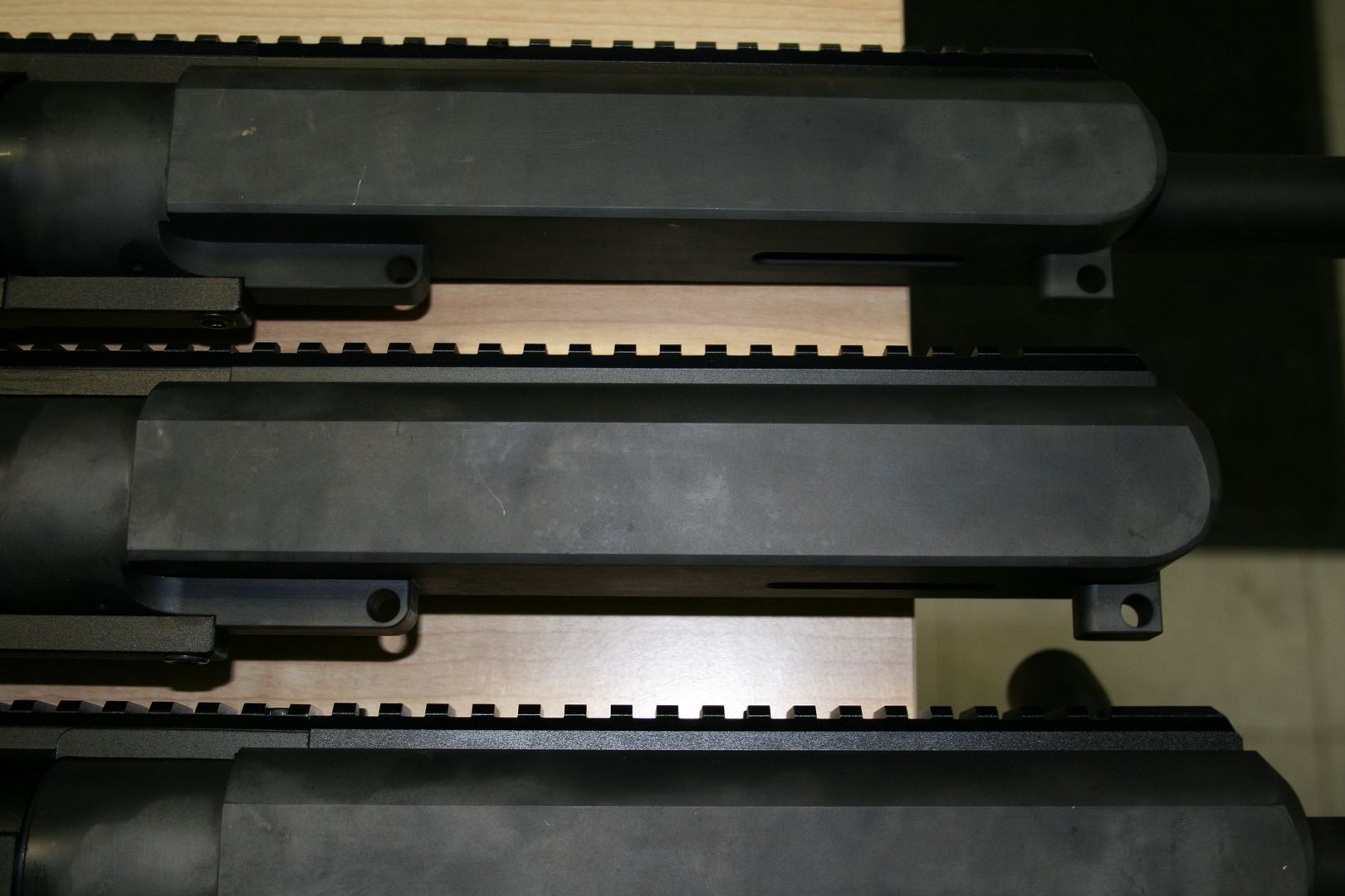

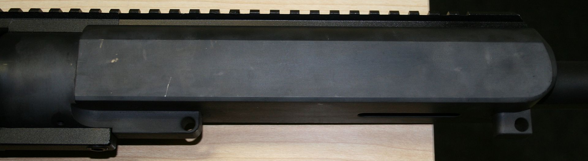

    Quote Originally Posted by clg View Post
    Why not contact ATRS and have them rectify this? This is not the proper avenue to have issues resolved when you haven't even attempted to get the shop to fix it.
    THIS would be my question too. It seems that guys are REAL quick to make assumptions, point fingers, and jump onto the internet to make problems rather than to think about things and deal with them in an adult manner.
    How we could get vise marks on the upper despite our application of several layers of tape to protect the upper from where the aluminum soft jaws of our machine vise holds the upper, eludes me.
    Leather is not an option as it will allow for movement of the part which makes for not only dangerous milling but inaccurate machining.
    Heat is an essential part of welding, we employ tig welding to minimize the heat transfer, but short of completely stripping, bead blasting and refinishing the upper there is no way to solve the heat changing the finish color.
    Same goes for the bottom of the upper. When the upper and lower are assembled you never see anyway.
    Photos of the uppers AS WE GOT THEM and prior to our doing anything on them..
    Last edited by alberta tactical rifle; 09-14-2015 at 11:30 AM. Reason: added photos and comments
