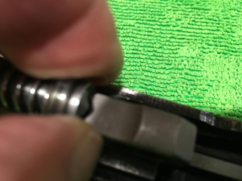

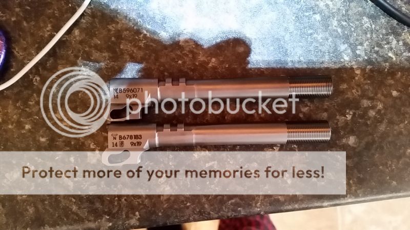

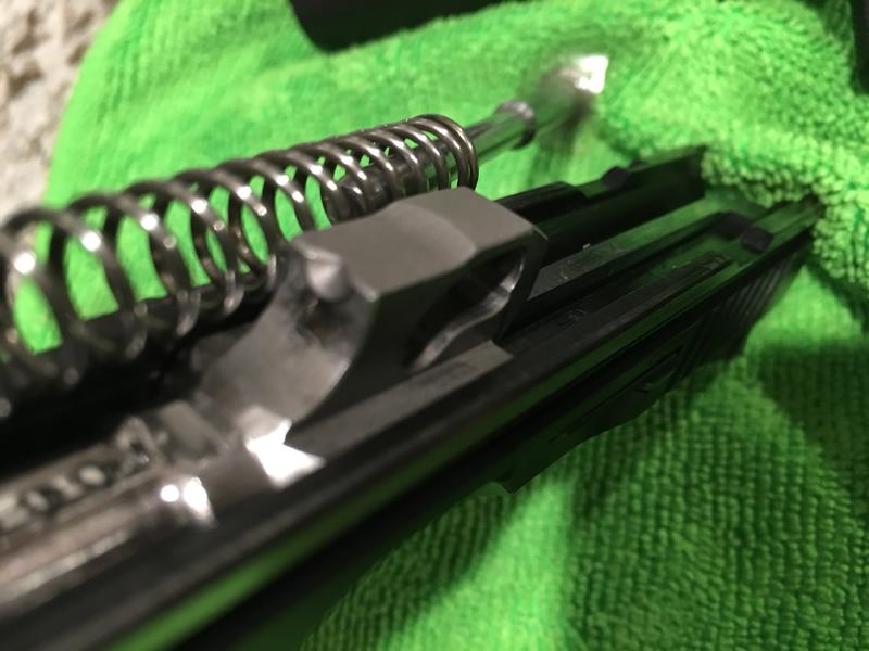

    Quote Originally Posted by keitha View Post
    Hey Please remove the slide and take a picture of the underside of the slide with the barrel and guide rod all in tact. There is an issue with the new barrel design where the guide rod does not sit in the correct location on the barrel which causes a little bit of play when the slide is forward and may not go completely into battery. This also causes the guide rod to not sit properly in the frame. I have seen this myself on the CZechmate with the new barrel design and CZ had acknowledged this is a problem and the solution is to mill a little material off the barrel. I really hope all these Oranges don't have that same issue but I am under the impression this was just discovered a couple days ago.
    All TS (Orange or Czechmate) have it. It doesn't affect reliability or function tho, the slide goes into battery even if the recoil spring guide doesn't sit completely on the bottom lug.
