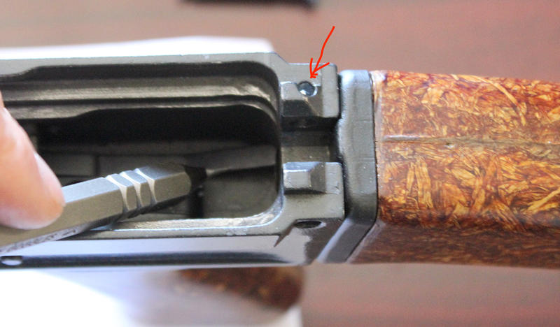

1. Remove rear sight using small punch (or something similar). Push down on spring and slide rear sight backwards.
2. Remove dust cover.
3. Remove dust cover pin by pushing down on spring in receiver (see illustration) to allow detent to let let pin past.
4. Re-install dust cover.
5. Place scope mount into position and install roll pin through rear sigh and pin through rear of receiver.
