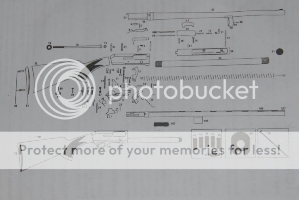

    Here is the parts diagram if that helps and the parts list - maybe this'll help someone help me figure it out
    Thanks!!
    Maybe this will help Frank from Marstar help me figure it out Monday - or perhaps John if he's online
