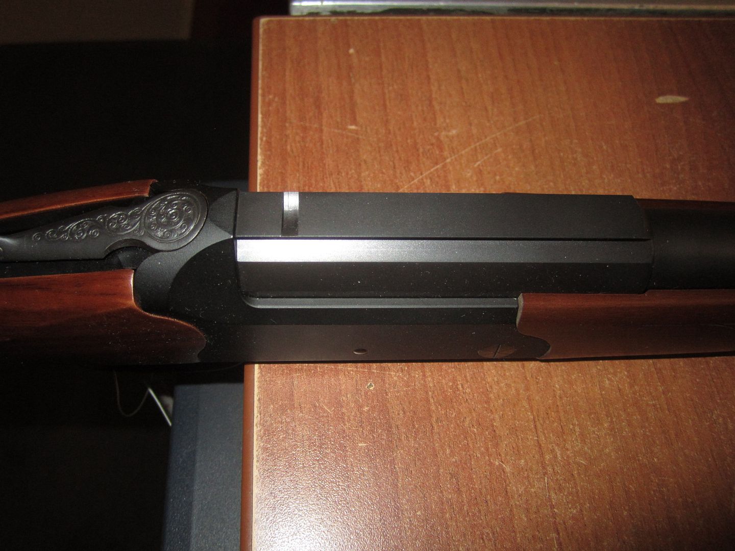

    Here is a view of the integral base. I measure it at just a hair over 11 mm.

    Yes, my mistake, the website says 12mm...so much for airgun rings. Anything you can come up with would be appreciated.

    Just a quick update for anyone who might be interested in one of these neat little guns: after my Haenel 9 (in7x65R) arrived, I began searching for a scope mounting alternative to the Haenel mount. That mount, although probably a typically beautiful and ingenious bit of German engineering, looks like the Incredible Hulk sitting on the gun. I wanted something more along the lines of the Black Widow ..slim, lightweight and sleek to perch on the tiny rifle.
    Trial and error experimentation produced some airgun mounts, both one- and two-piece models, that fit the grooves nicely. Sorry, I don't know the manufacturer or model number, or even where they came from...they emerged from my accumulated hoard of bits'n'pieces. Unlike many that I tried, the two-piece set I finally selected tightens on the grooves nicely, and their integral recoil-stop pin mates perfectly with the recess on the Haenel. I've only put about 40 rounds through the gun so far, without any difficulty. Similar rings have survived several hundred rounds of full-power .45-70 in a lightweight Baikal SxS double rifle, so I don't foresee a problem with the 7mm Haenel. This gets me shooting with little fuss or expense, but I doubt it is the permanent solution.
    I toyed with the idea of drilling and tapping the nice flat top of the Haenel and installing a flat-bottomed Weaver-type mount, thus allowing the use of a multitude of different rings. A base designed for the Marlin 1895/336 series, or one for the top flat of an octagonal-barreled muzzleloader, is very versatile for this purpose and I've used them with complete success in the past on several oddball guns. I'll probably go this route eventually, but I'll wait a bit. There are a number of European-made mounts for this gun, including some in alloy, which will result in a cleaner, smoother package. I'm hoping John at Wolverine can come up with something that won't overbalance and overpower this little gun.
