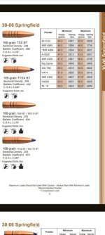

I picked up a box of 168 grain TSX yesterday, the regular TSX not TTSX. I am going to be firing them from a 30-06 rifle with a tight chamber. Hoping to avoid pressure problems. So wondering what powders people have been using that gave low pressure. If anyone has the barnes book that could tell me the pressure figures for the different powders on that bullet i would really appreciate it.
Thanks!
I too was about to load the same load for my new 06. Anyway I’ll be trying Imr 4350 and the 4 or 5 sources I checked were starting around 53g and maxing about 57. Myself I’m aiming for about 55g and hope to get more life out of the primer pockets that my hot loads have in the past. See how it goes?
