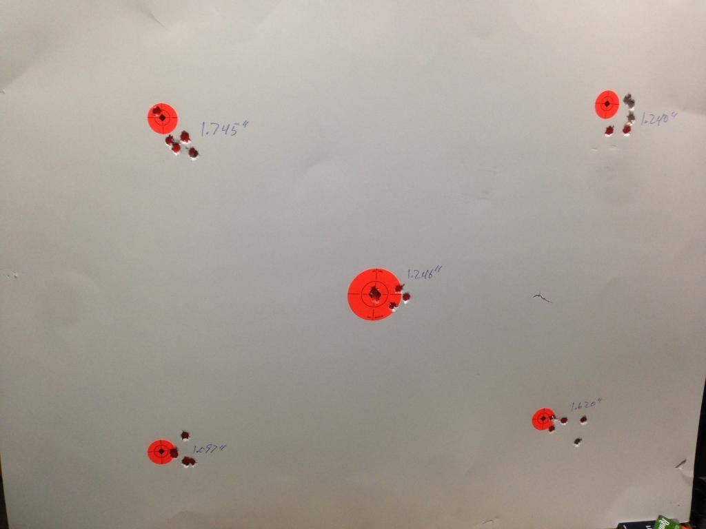

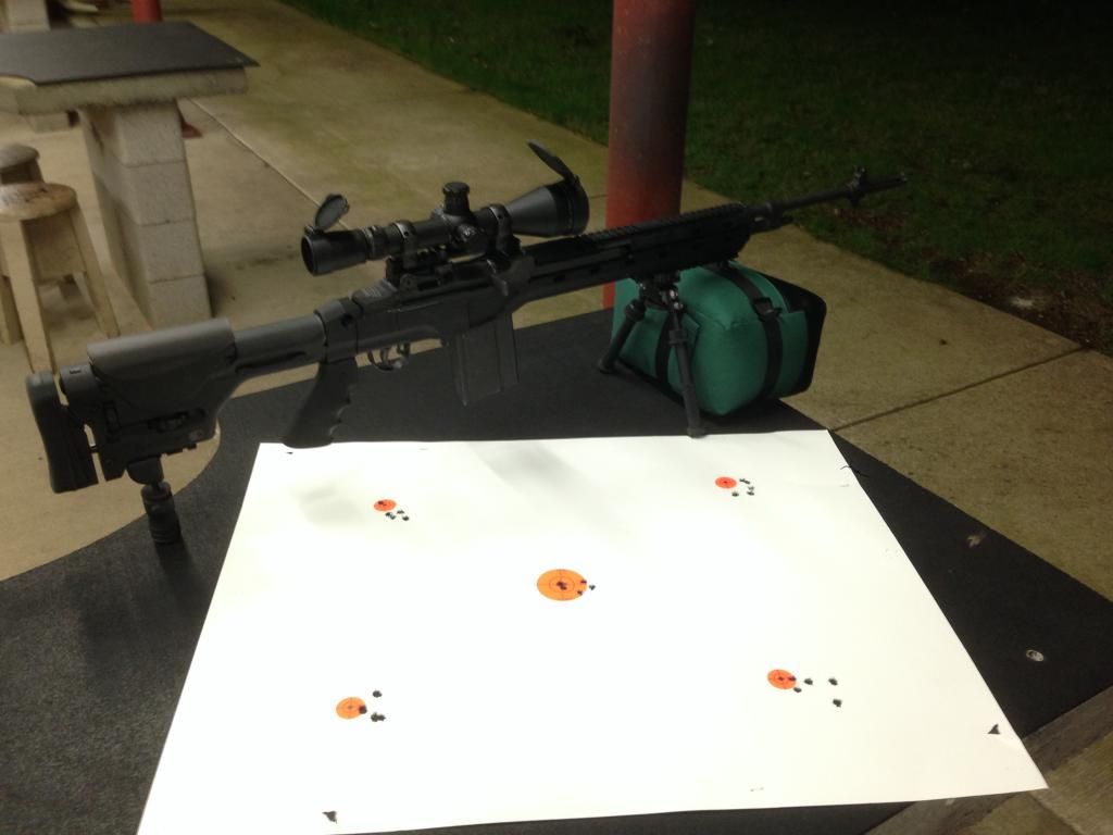

    Here's an update from a session I had last week...
    I went shooting last Saturday at the 200, hoping to get the Leupold zeroed in and see how things worked out. As I leaving the driveway, the mailman was dropping me off a package. It was the high stock adapter that Frank sent me! I threw it in the Jeep and off I went.
    I installed it at the range but my Warne rings were just too low to work with the high adapter and they were too high to work effectively with the low adapter. I went back to the CTR (all this was happening at the firing line) and I got zeroed in at 200. I drew a large vertical line at 200 with a carpenter's level and a fat sharpie so I could level my crosshairs at the range.
    Well, just loosening the rings enough to rotate the scope threw me off target completely at 200! I packed up and went home. I threw the Warne low rings in the "maybe I'll use them again someday" box and I installed the Leupold Mark 4 medium rings that Leupold sent me. They were just a tad too low to work with the RBS and the HBA. I could have used it, but I would have had sore cheekbones at the end of the day.
    Luckily, M14 forum member bfoosh06 met me and loaned me his Magpul PRS. (A BIG THANKS!!) Once I got it all installed, I found the perfect combination of stock and cheek weld. The clouds parted, a ray of sunshine beamed down and doves flew; PERFECTION!!!
    I was supposed to meet up for a 600yd shoot Tuesday night but high gusty winds cancelled the 600yd night shoot. No problem, I just hit the 100 and re-zeroed my scope this time, so it definitely wasn't a waste. I had already planned on showing up early and getting re-zeroed before the 600yd shooting begun. I hung a plumb line at 50 and got the crosshairs level and proceeded to zero the scope. It's on permanently now so I can move on to other things.
    50 yard groups clover-leafed nicely with my plinker ammo. It was VERY gusty at the range last night, so I don't know what groups would have been if it wasn't gusty. I suspect that 125's in 20 MPH full value winds might have some drifting. Had it not been for the berms on the sides, winds would have been 30 to 40 MPH. I was also battling a shifting target. It would rock left to right in the target stand, so I had to wait for it to settle before breaking the shot.
    The material on the tabletops did not allow a good enough grip for the Atlas bipod to get a good preload. This is also the first time I've shot the rifle with a monopod and my first time shooting with a monopd as well. bfoosh also put some neoprene padding on the PRS as well as an aftermarket mushy buttpad. It made for perhaps the most comfortable shooting experience I've ever had! I'm sure once I get some high rings and put on the RBS, it will be just as comfortable.
    The shims have eliminated the vertical stringing altogether, but I found that after 50 to 100 rounds, the heel pounds on the shims so hard that they start to compress and "flow" out the sides of the heel. I bedded the heel over the aluminum just for longevity. This took about an hour's worth of prep but it looks good. My next range trip will be at 200/300, now with a bedded heel. Had I not resolved that before I shoot long range since using stout ammo I could see shims compressing and I can envision groups opening up and shifting which will be very frustrating at 600+. Steel shims would work well too.
    I have a good feeling about my next range trip.
    Tony.
