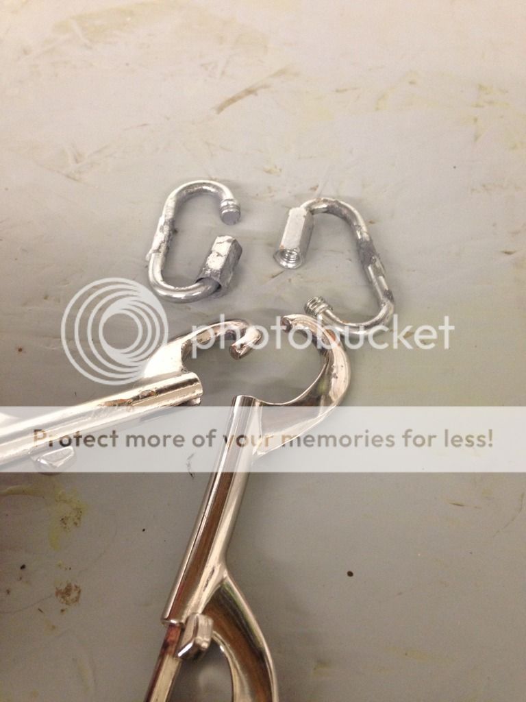

They didn't fair well, that was hanging my gong at 1000 yards, maybe 10 hits.

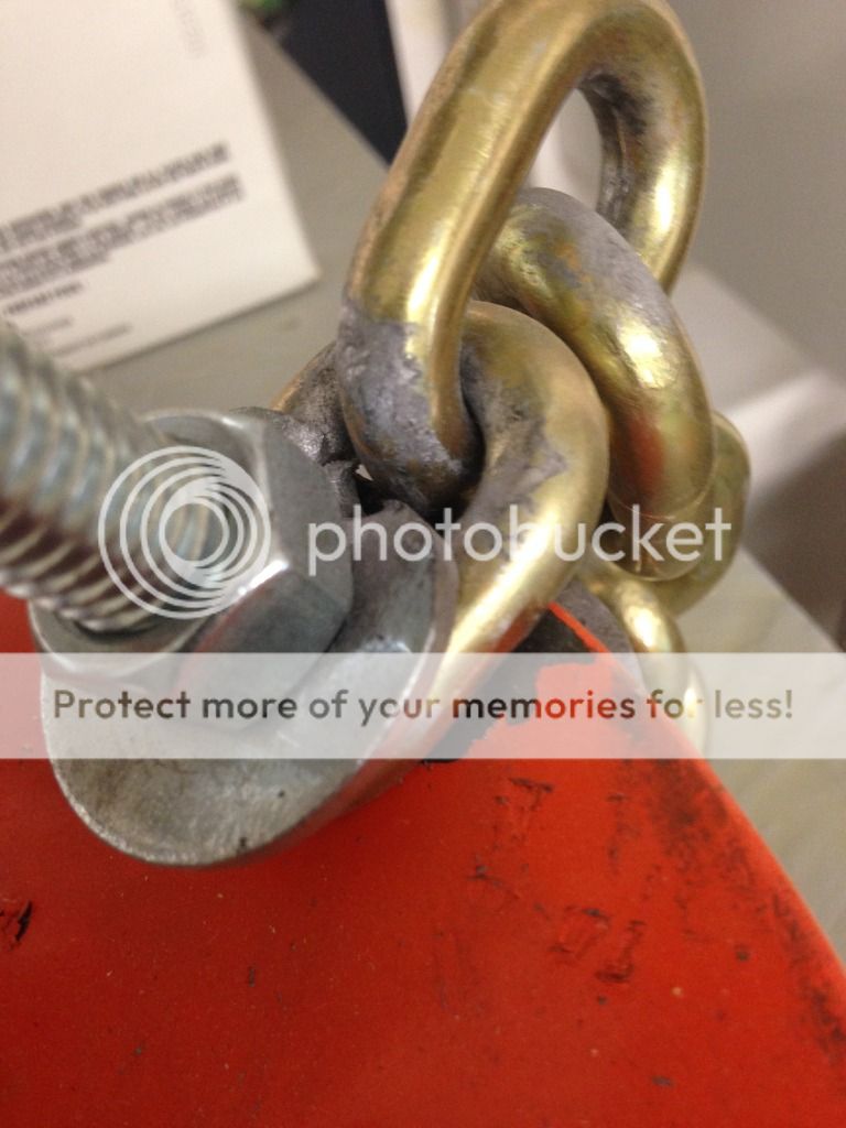

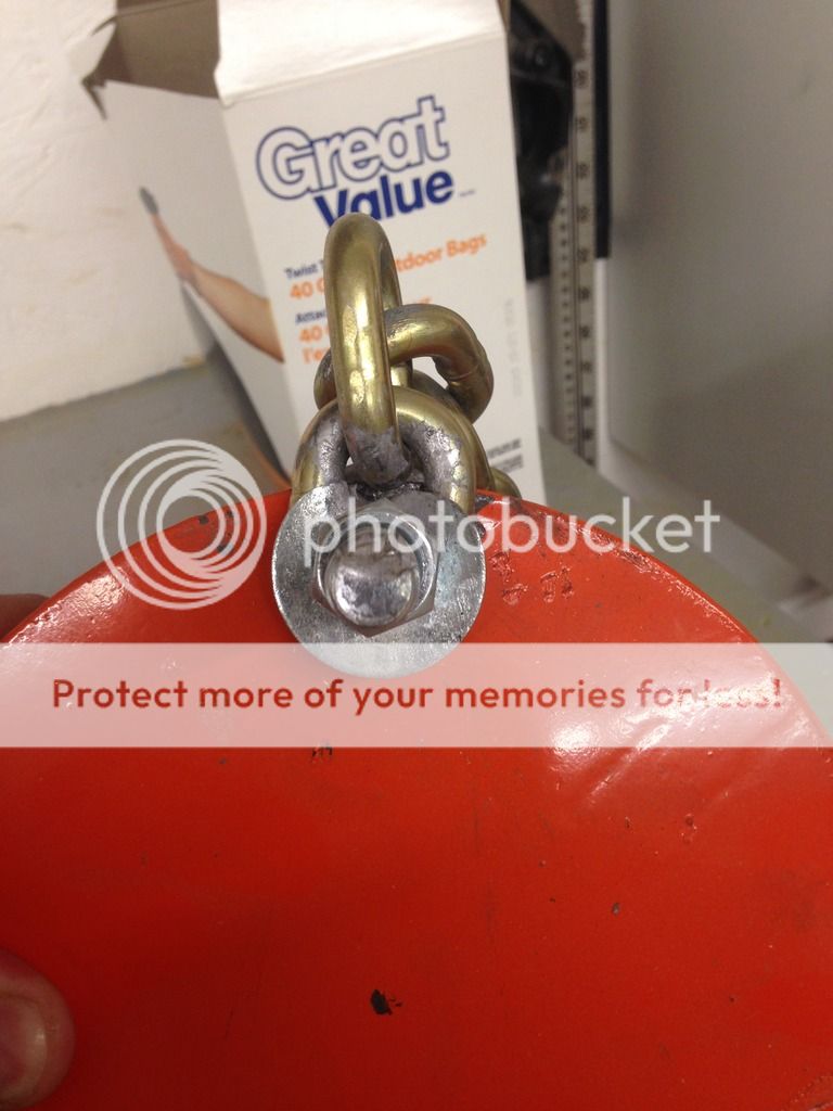

300gr SMK @ 500 yards.Bullet just touched the end of the bolt then into the washer and chain.
300gr SMK @ 500 yards.Lead deposits on chain, no other damage.

Your quick links and small clevises won't finish your day of shooting.
You will need some grade 70 minimum chain , bolt it to the back side of your plate.
There is a lot of whipping going on when that thing takes a hit.
The angled legs don't take much shrapnel, but my snap hooks didn't make many shots , had to switch them out.
Used quick links for my smaller gongs and they didn't make it either.

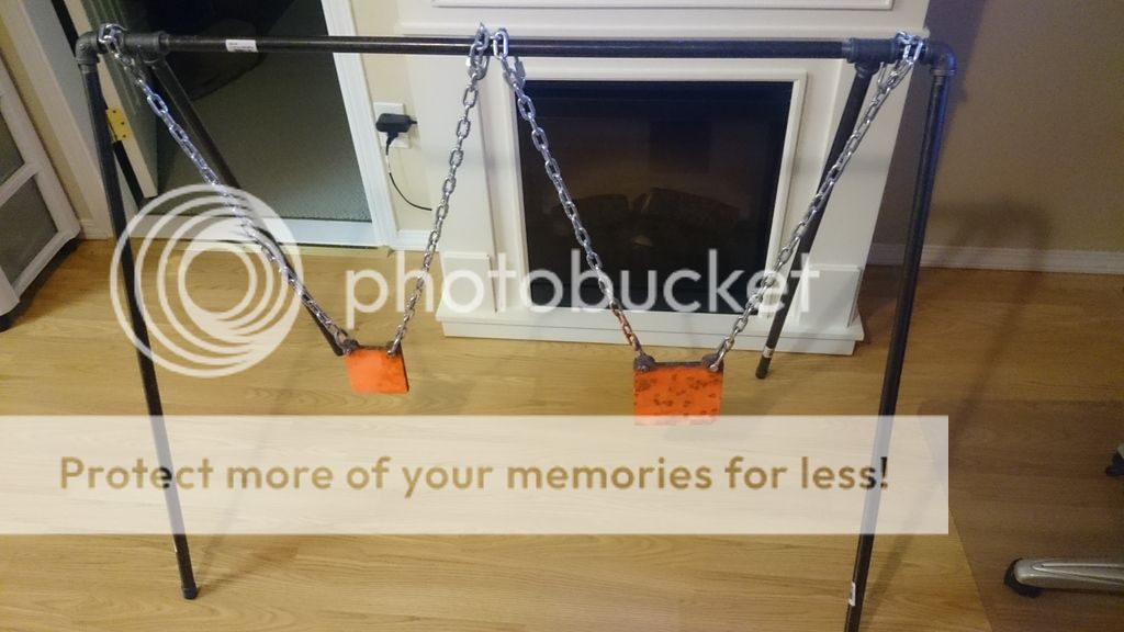

Here are my gong set ups
In the first pic, you see how the frame is built on an angle, with the gongs hanging slightly behind the frame. This is to reduce the shrapnel cutting the wood up. These are pretty new frames but I also attach a sacrificial scrap 2x4/plywood, whatever to the frame where the shrapnel hits. You can use anything for this, really. Busted up old pallet, whatever is cheap or free. I didn't have time to do them at first, but these stands now have the scraps on them to eat the shrapnel.
In the second pic, you can see what I've decided on to hang the gongs- 5/8" angle iron and shackles that run about $2.50 each. They last a long time and even when they get hit they will continue to hold up until completely smashed. I used to use black rubber bungee cords, but they only work well with the heavier gongs as you need the weight to hold them in place. They last surprisingly long , actually. Even longer if you sleeve them with some scrap PVC or poly pipe to collect the shrapnel.

Just put one together today. Cost ~$35 for all the parts from Home Depot. I used 1/2" pipe and fittings, but you could always use 3/4" if you wanted to spend more. I've got a 4" and 8" square plate hanging from mine so far, though I want something larger as well (maybe a silhouette or 12" round)
