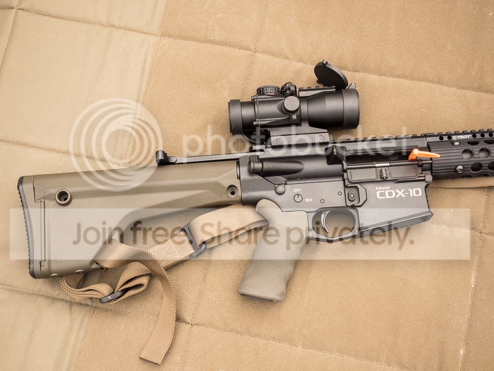

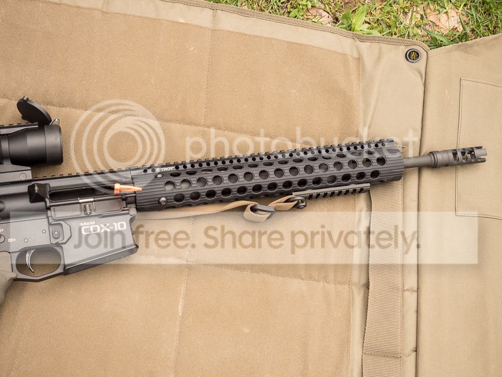

    Craig,
    I have one of the cadex ar-10s. Wolverine is your best bet as they have most if not all armalite parts needed for your build. There are no standard ar-10 specs and parts are not interchangeable like ar-15s. You will also need an armalite upper along with barrel and bcg as the head spacing is different. The handguards are also unique as the threads are different on the upper. I had some issues with the lower interfering with the bolt stop preventing the bolt from sliding freely. Cadex sorted it out for me at no charge. Feel free to pm me if you want to chat about it. Great rifles once its done. Love mine.

    Would you mind sharing your build and what exacly Cadex did to fix the bolt catch issue?

    No problem. I'll post the info with pics when I get back home tonight.

    Hello Sir
    I'm no specialist in AR10 platform as this lower receiver design was for a special development project which occur years ago when I wasn't at Cadex yet. To my understanding the CDX-10 lower was designed to fit the Armalite and Noveske style of uppers and parts. So this mean that all parts must be "B SERIES" parts which is for M14 (metal) style mags.
    So all internal parts must be "B SERIES" which was a problem in the case of Rickster66 who had one part of "A SERIES" that required some machining to make it compliant. It was easier for us to rework his "A SERIES" part to make it compatible than to let him leave with his parts non-compatibility issue. We cannot do this all the time so if you are looking at buying this lower in stock at a Cadex dealer make sure that you order the right internal parts.
    Cadex is out of stock and for the moment we do not plan on starting a new production run as the minimal quantity isn't reached to make it viable. This is not a big seller in Canada and since we are not authorized to resell these in USA then it kills most of the business opportunities.
    I hope that this anwers your question. if not I suggest this link: https://armalite.com/files/2015/01/A...s-Carbines.pdf
