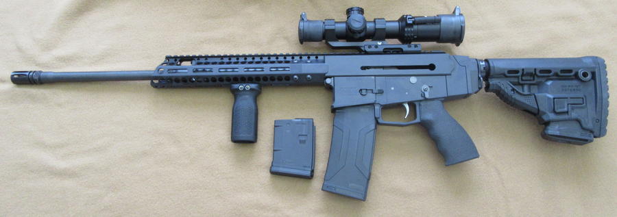

    Took the gun to the range today. Fired 20-25 rounds... experienced 4 FTE’s where the fired round stayed in the chamber and new round was stripped off the mag, and picked up. Occurred with one of the supplied mags and one of my Norinco mags (only took two mags).
    Any suggestions for me to look at here?
    Please check your extractor and advise.

    Extractor looks A-OK.

    Quote Originally Posted by Duncan71 View Post
    Spring look normal?

    Removes the extractor spring and compared with a used brownells spring I had kicking around. The WK spring was noticeably shorter. .139 in vs .179. Will give it a shot tomorrow and report back.
