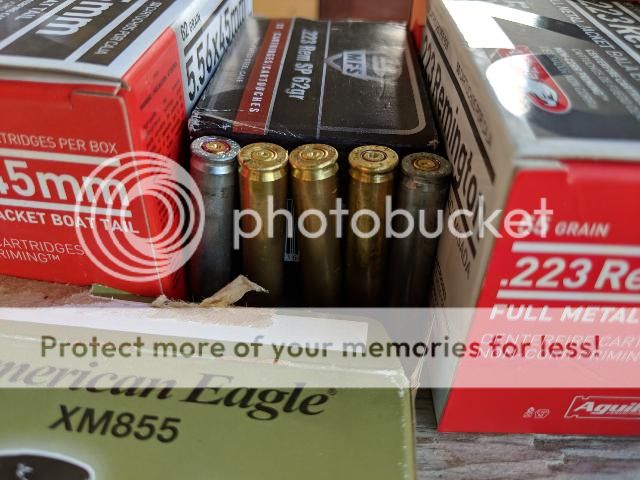

The S&B I have that popped the primers are still under SAAMI spec of 2.260 max (they are 2.2325) but if the rifle chamber is short throated then excessive pressure will get built up and it has to go somewhere.
'Some' 75-80 grain 223 are loaded longer than 2.260 spec and definitely would not feed/fit in an AR magazine. You can get/load some 75 and 77 gr to 2.260 but they would still need to be under certain pressure limits.
