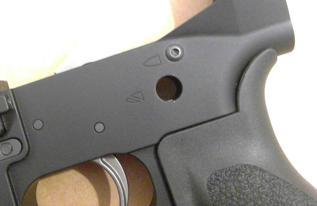

    If you use this in place of the fixed rear pin, then you can use whatever trigger you'd like, and simply pull the pin out to take it down. We're researching potential, and optional modifications's that can be done to the rear takedown pin/crossbar but frankly haven't had the time to come up for air, or eat last Thursdays breakfast yet, let alone R&D into mods. There have been a number of guys asking if they could somehow have their front and rear takedown pins matching...

    Would still be able to run the same front pin as normal. Just run the pin posted here in the rear if you want to use the Trigger tech adjustable.
    The way they mate wont allow the upper to pivot on the front pin either it's a push down and back type of mating system. That's why there is a hook instead of a hole

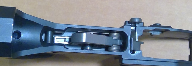

    The hook on the upper that’s hooks on the lower takedown pin is hitting the top of the disconnector.
    I was thinking I could remove the takedown pin, Nate the U/L and then re install the rear takedown pin.
    But when I tryed removing the torque screw, everything just rotated.
    Any recommendations on what to clamp on the pin, so it do not rotate ,while removing the screw

    Oh yeah I get how it goes together, I just don’t like the pins pictured for a rear. I’m just running a Milspec Trigger, I want the rear pin for ease of use. If they don’t want to do it I’ll just pull it apart like it’s designed.

    The top of the disconnector where the first stage adjustment screw is located, is to high and it brings up in the hook on the lower.
    You could remove material from the back of the hook, which I’m not gonna do.
    I’m gonna remove the takedown pin and try and join them first.

    Taking that pin out is a Beaach!
    The small screw is locktited in.
    You have to grip on the needle nose with the grip of Thor
    After removing the pin , I got the U:L together, but it wasn’t easy.
    You have to tip the upper on a coward angle to the lower( kinda like putting them together backwards.
    The front will not pivot, once the back pin is out.
    So now for the weird stuff.
    Riding the CH will allow the trigger to work.
    Slamming the CH will not engage the trigger.
    Trigger works with a mag when you release the bolt via the bolt release, but not when you release it manually.. (dummy rnds)
    Then it’s opposite on an empty mag.
    Also the maritime bolt catch is very stiff.
    I think the trigger is causing all these issues and is a no go.
