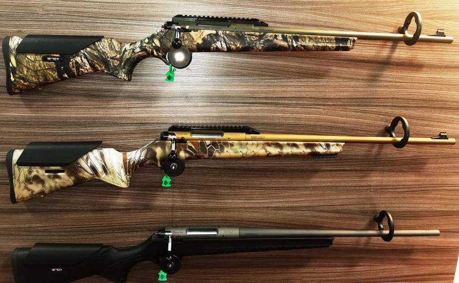

    Monza Rifle , new to Canada 308 Win. basic model $650
    FRT approved. Arrival time March-April 2020
    Calibre: 308 Win.
    Barrel Length : 20 inches (ca. 51 cm), 22 inch (ca. 56 cm) and 24 inches (ca. 61 centimetres).
    Stock : Currently available black synthetic. Other Colours available(Optional).
    Technical Information:
    1. Smooth and adjustable trigger.
    2. Simple easy disassembly bolt design.
    3. Reliable, 2 position Safety.
    4. Mil Std 1913 Picatinny rail.
    5. Adjustable Hidden rear sight.
    6. Light weight 3.2 kg
    7. 4 Groove 1:12 Twist, 11 degree Crowns, Button Rifled, Free Floating Barrel.
    8. Adjustable Tru-Glo Fiber Optic Front Sight.
    9. Compatible Swivel.
    10. Picatinny for Bipod Installation (Optional $25 CDN).
    11. Detachable 4 Capacity Magazine.
    12. Ergonomic Buttplate.
    13. Adjustable Comb Riser.
    Additional info:
    Simple Bolt
    Bolt mechanism of Monza can be disassembled without any tools. Simply by turning the firing pin cap allows you to remove and clean firing pin, firing spring and follower in the field when its required.
    Perfect Feel of Trigger
    The trigger pull weight of Monza is adjustable between 2.20 lbs(1 Kg) to 5.30 lbs (2.4 Kg).
    Length of pull is adjustable + - 9,5 mm. Adjustable for creep and over travel.
    Reliable Safety
    Locks the bolt and trigger in single movement.
    Free-Floating Barrel
    Free-floating, button rifle barrel with 4 grooves, 4 sets has 1/12 RH twist rate and finished with 11 degree crowns.
    Removable Open Sights
    Front sight can be removed or adjusted. Rear sight hidden in picatinny rail to prevent contact with scopes.
    Effortless Stock Replacement
    Changing the stock between wood, black synthetic or camo can be done easily with provided T-handle wrench.
    Special Introduction Price : $650 CDN (Basic), $689 CDN Lux Model(with adjustable Comb Riser).
    Exclusively distributed by Westrifle Canada. Dealer pricing available.

    Two or three lug front locking bolt?
    60,70, 90 degree bolt handle? Welded or threaded? Modular handle?
    Extractor type? CRF, AR style?
    Action style compatible with others (R 700) for stock compatibility?
    Single stack mag? Higher capacity options?
    Like the rear site function that drops down into the picatinny rail. Does it bolt to the barrel or action at the front? As it protrudes past the action onto the barrel..

    Quote Originally Posted by cody c View Post
    I know answer to some of them but I asked manufacture to answer them as soon as I get the answer I will post here.
    Rails from Remington 700 fits on this rifle.
    Magazine, ....working on 10 rds at this moment. What is the request for a number? I have talked about 10 rds with them.
    60 degree bolt handle I believe but I will confirm with them

    A quick Google search seams to point at a Turkish manufacturer Istambul Silah. The Monza in 308 kicked off in 2018. 2 lug bolt with 60 deg throw, 4 grooves and 1:12 twist. Safety is on the front of the trigger guard. That's the most I have come up with. I guess I will wait for Westrifle's post for the rest of the specs.

    Quote Originally Posted by Kraco View Post
    Yes manufacture is Istanbul Silah, they make some impressive shotguns. Production of rifles did not start until the end of 2019. You are correct with most info but I wan to confirm first with manufacture.
