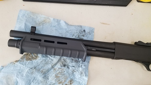

    Does the magpul forend require mod to fit a 14''?
  10. #10
    Canada Ammo - CGN Sponsor CanAm's Avatar
    Join Date
    Mar 2004
    Vancouver, BC
    Posts
    19,826
    Quote Originally Posted by EthanW View Post
    just a light sanding to match the metric tube
