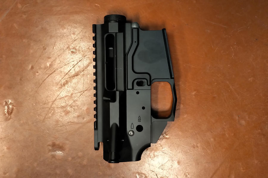

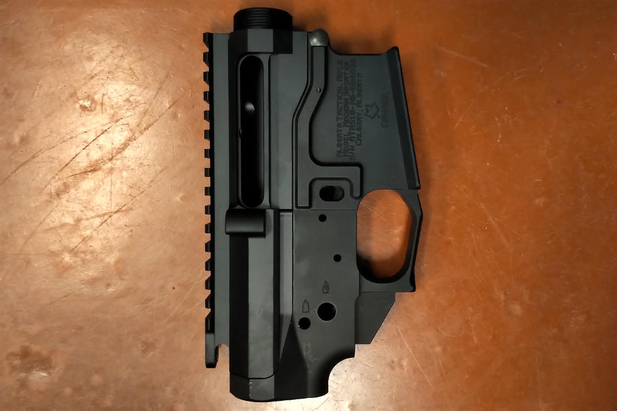

    my friend mike says if you file / cut 1-2mm off the pmag stopper they will seat. is manually cycling snap caps fine.
    https://imgur.com/a/hoZsRfI
    also as above his charging handle does not pull far enough back to engage the bolt lock. if it's pulled hard enough it's starting to lock after some cycling, as the handle wears down. need to file away the charging handle so it can slide further back. or have some custom ones made with the whole lug moved further forward on the handle. bolt goes further back if pushed by hand. not buffer issue.
    https://imgur.com/a/dDaJ5s1

    Quote Originally Posted by scott View Post
    That’s common on the MS also. Make sure your buffer tube is in spec. The sterling upper is shorter overall than an Ar. Much tighter tolerance for the bolt face to clear the catch.

    Quote Originally Posted by robab View Post
    wrong tense used there. WAS. There was a small number, perhaps 50 or so, at the start of the second run that were 0.017" too low at the rear of the magwell for the Gen3 Pmags stupid little anti-insertion tab.
    We had to manufacture our own unique tooling to be able to machine in the extended track for the charge handle, underneath the rear hook. It looks on the TSR that they made the rear hook slightly smaller, which maybe just enough room for the bolt catch. I haven't seen one with parts in it though.
