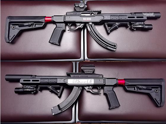

    Received the chassis. For Dlask TUF22 receiver users, a little bit milling and drilling works need to be done before putting in this Spectre 10/22 chassis. I'm still waiting for the buffer tube and castle nut before posting the whole setup here.
    And the Dlask extended magazine release (long) doesn't work very well with the 3D printer insert, I assume the short version works fine. Turned out I didn't use the insert and leave the gap there.

    Just heads up, I tried to put Grey birch 10/22 receiver in the chassis, and found out the chassis takedown screw hole does not align with the receiver even I've already drilled the hole a little bit bigger in order to fit the TUF22 receiver.

    I just did the measurement, the takedown hole on Grey Birch 10/22 receiver is about 1mm further than the chassis if look from the bottom, and I've already enlarged the hole about 1mm in order to fit the TUF22 receiver.
    And I have a Titan 10/22 stock which can fit both TUF22 and Grey Birch receiver without any issues, so I assume its all about the rear of the SBI chassis not the front. My 2 cents
    UPDATE: my final part was arrived yesterday, so here it is. TUF22 receiver with Dlask 8" barrel mounted 5" fake can on the barrel end which makes this setup still under non restricted status. Can't wait to shoot it at the range.
