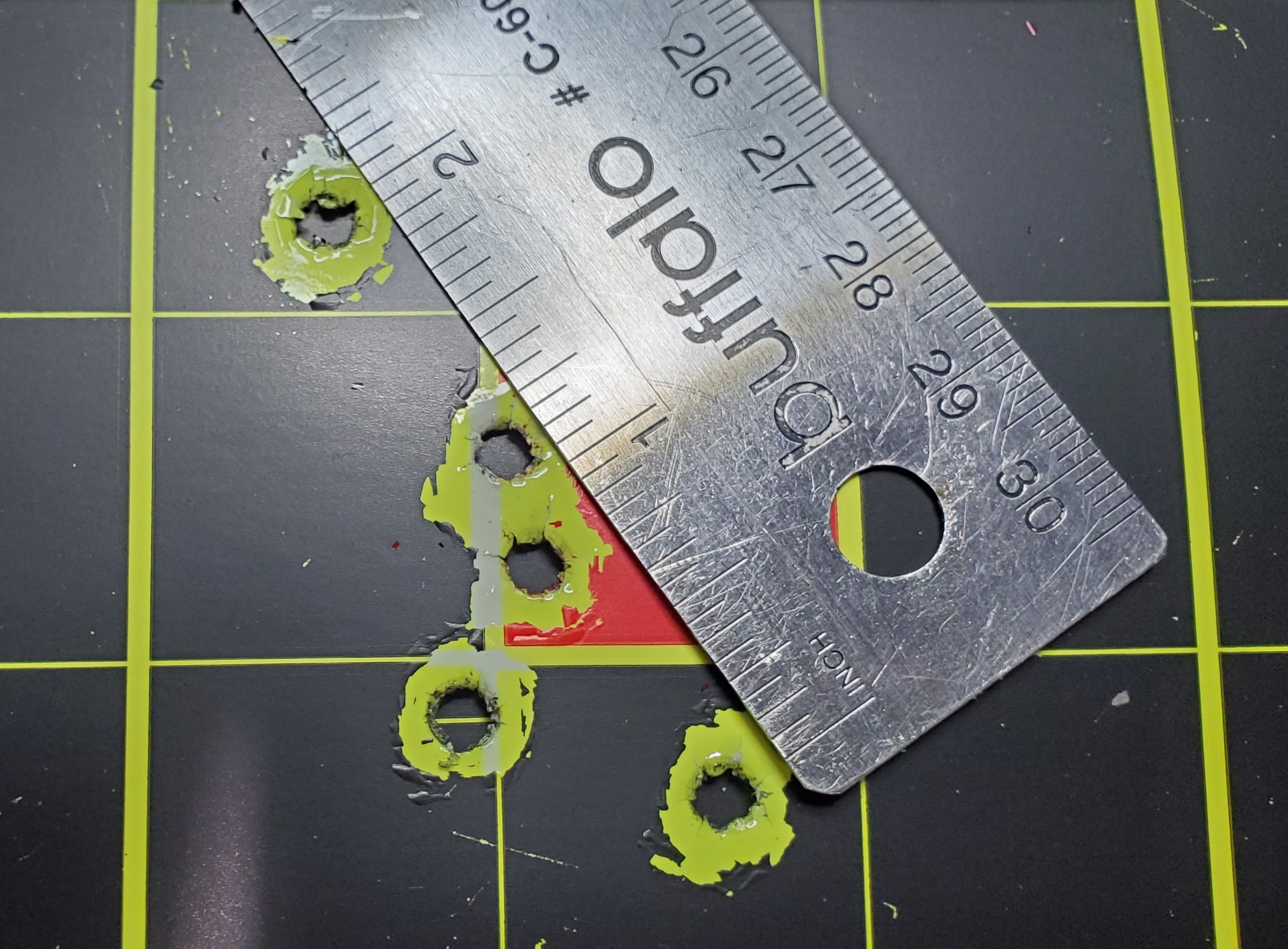

The results of accuracy testing were acceptable, but not as good as was hoped for especially when it came to Match Grade Ammunition. Average resuts for PMC XTac 55 grain 5.56mm Ball hovered between 2" and 2 3/8".

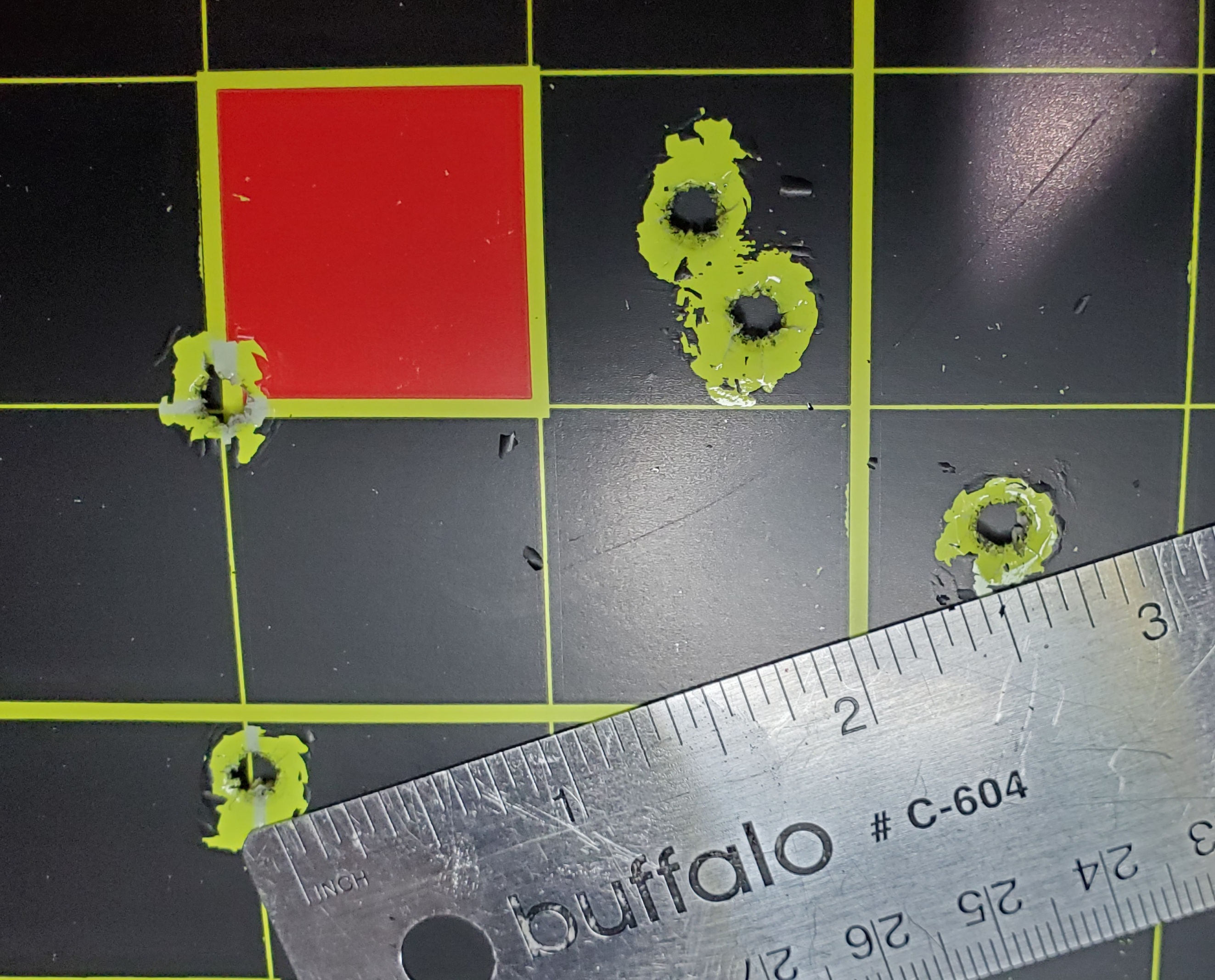

The R18's 1:8" Twist Pencil Barrel doesn't seem to particularly like the heavier 77 grain HPBT bullets found in the IVI LE load. Groups with this heavier load averaged 2 1/4" to 2 1/2".

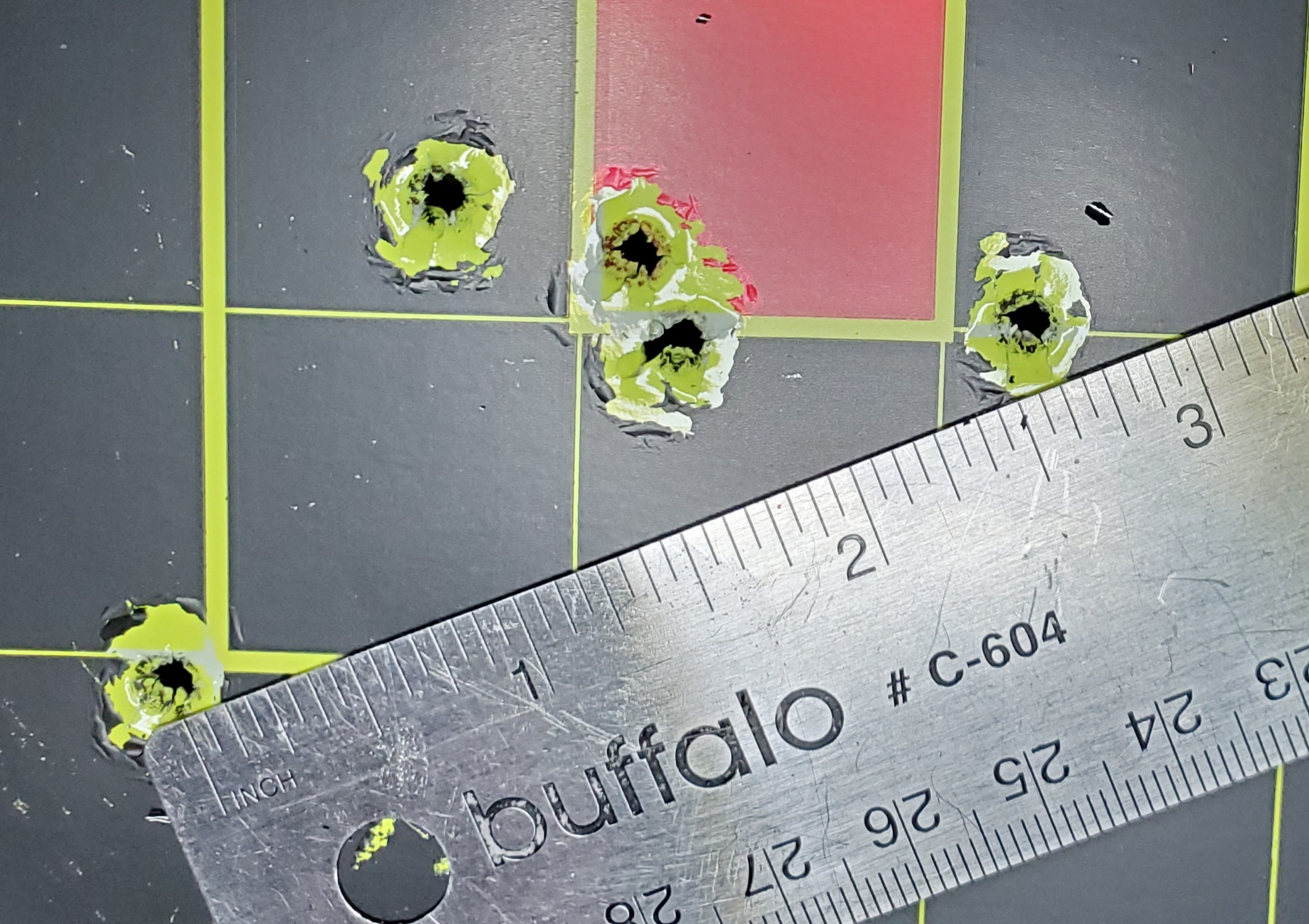

Finally the Match Grade ammo. First up was Federal Premium .223 with a 55 gr Nosler Ballistic Tip. The result was a mediocre, but acceptable 2 1/4" .

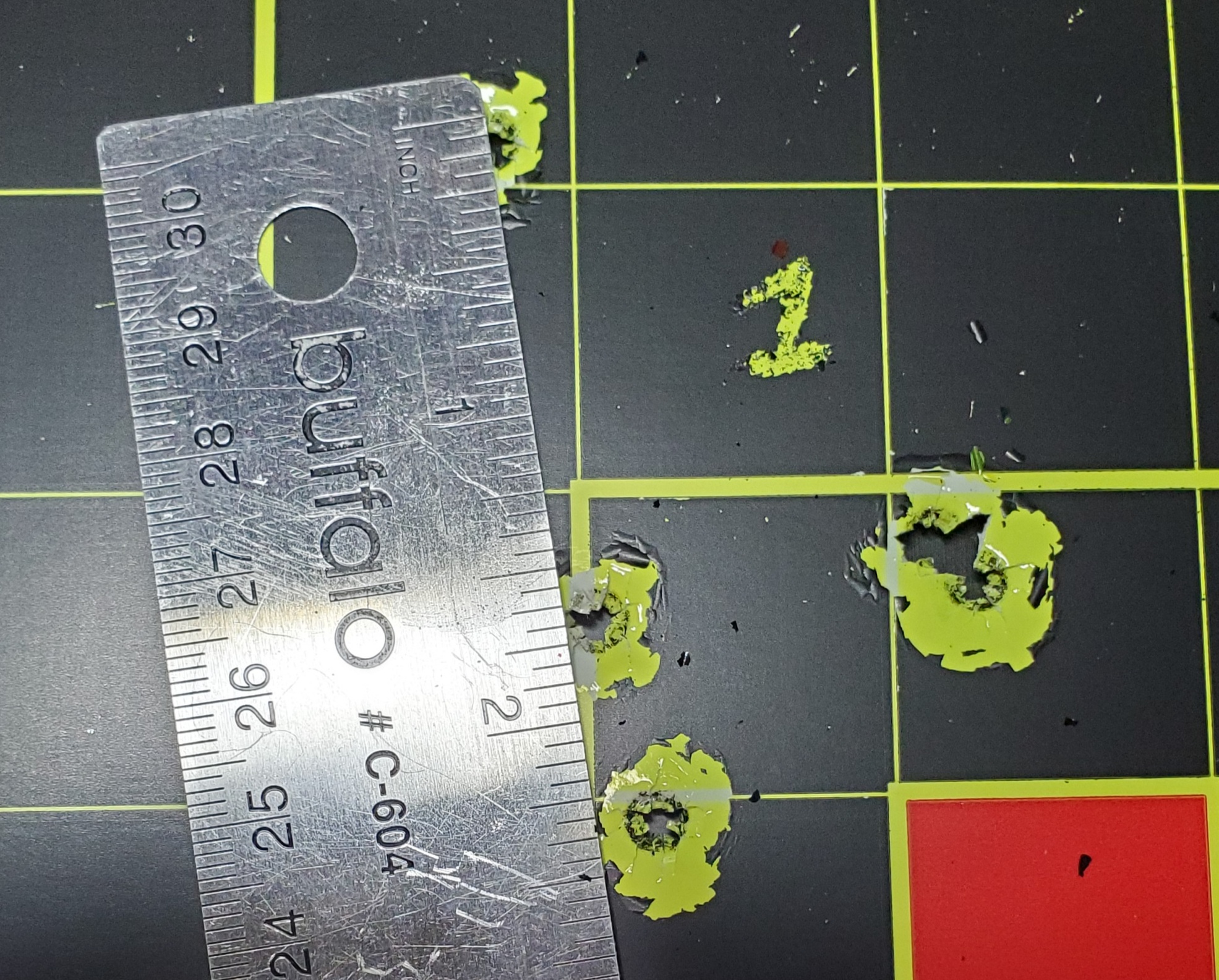

Next up was 53 gr .223 Hornady V-Max Superformance Varmint with a very similar 2 1/4" group.

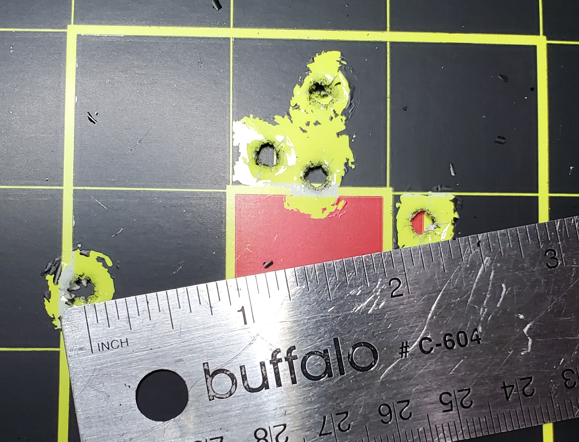

The final load of the day was Nosler 77 gr .223 Hollow Point Boat Tail Match with a group measuring 2.5". It is worth noting that all of the declared group sizes are inclusive of "fliers" which in many cases expand a 1.5" 4-round group to 2+".

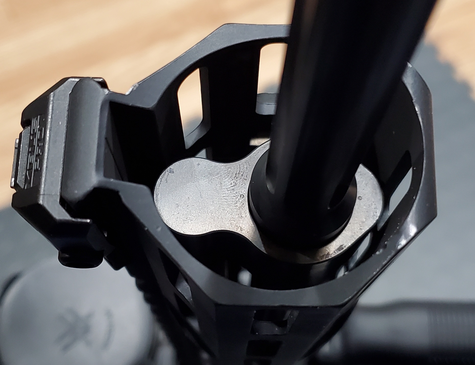

The accuracy, at 2-2.5 MOA is acceptable for a pencil barrel, but is still not optimal. Properly free-floated, the Barrel ought to perform better than it has to date. The apparent problem is fliers - usually one or two per five-round group. Those fliers typically open up the groups from 1.5 MOA to 2 MOA+. So what's causing those fliers? After careful examination of the Test rifles I believe that there are two issues at play. The degree to which each of these functional issues is impacting accuracy I cannot say for certain. What I can say with some assuredness is that the issues are legitimate. The first is that the Gas Block is impacting the Handguard during firing. The clearance between the Gas Block and the Handguard is inadequate such that Barrrel Harmonics/Whip is causing the Cap Screws in the Gas Block to mar the inside of the Handguard through the anodizing down into the bare aluminum. This suggest significant force behind the Gas Block when it strikes the Handguard. The plan is to have SAI reduce the bottom profile of the Gas Block to create additional space between the Block and the Handguard such that contact during firing is eliminated. Note the proximity of the Gas Block to the inside of the Handguard in the following photos:
