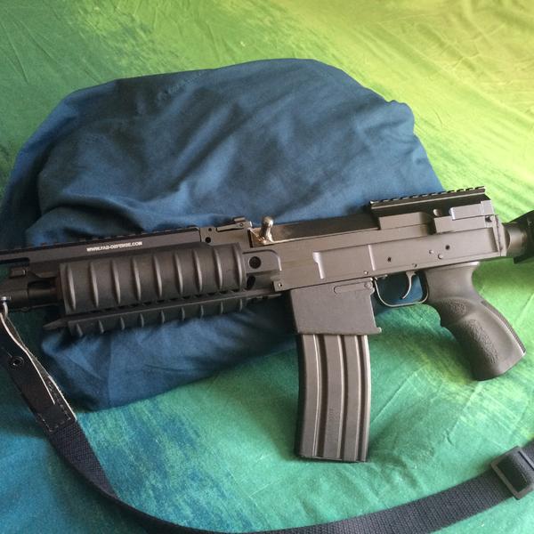

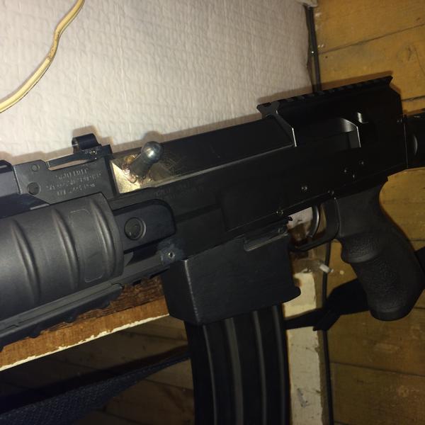

I havnt got out too shoot yet. But cycling with dummy rounds it works great! The machinist made up a second one in the same time as the one I have. But then just finished the one. The other is about 80% done. I will post after I go shoot. I'd post some pictures but there's always an error when I try.
Definitely post up pics of it if you can, i'm sure curious how he did the bolt hold open. I can't see an easy way to do it without making a new bolt hold open device that goes inside of the adapter somehow.
He didn't have to make a new bolt hold open. All he did was the Magwell. Just took the dimensions from the plastic csa adapter and it from aluminum
It's not my intention to start selling these. If it were I definitely would put it through a beating to see how it holds up. It's just something I've been working on and thought those like me with the vz in .223 would be interested in.
image.jpgWent to the pit on Saturday and fired 140 rounds through without any issues at all. Everything works as its supost too. I'm very happy with the turnout of the adapter!

Thanks! And same with me. I became obsessed with having an aluminum one. Takes to the machinist that does work for my boss and he came up with this. It's two pieces about 3/8" thick machined out and then pin and wielded together. It came out great! Works flawlessly I just stole the parts from the csa adapter fine fitted everything and it works great! Although it wasn't cheap! Lol but I'm happy!
