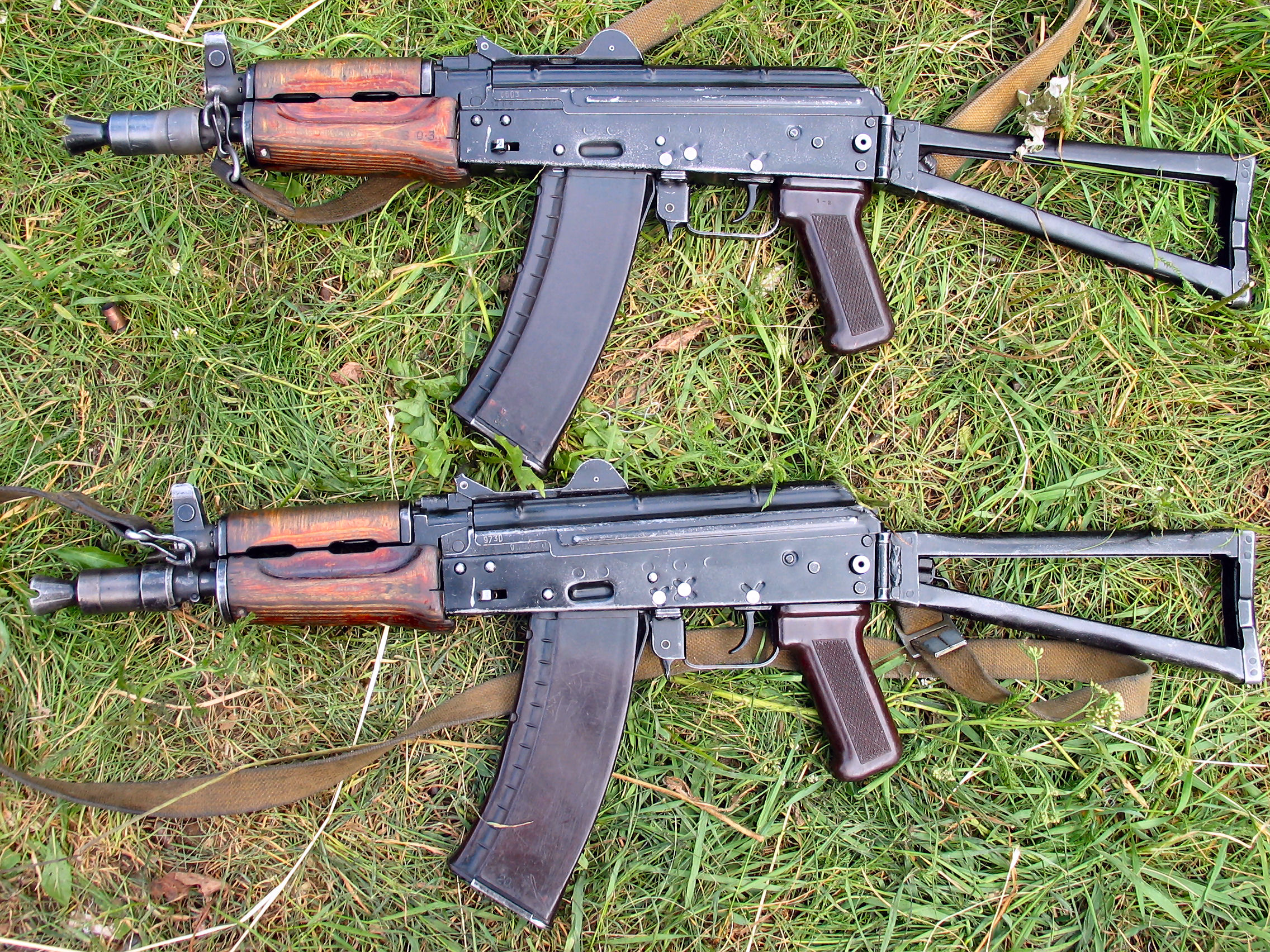

    is it possible to incorporate a blast/expantion chamber ala krinkov flash hider into design? I would live to have krinkov flash hider because it has an expantion chamber to help with more reliable cycling of the very short barreled rifles. But for some reason NEA is no longer makes them. Let us know if you might make something similar to original AK-74 u flash hider with expansion chamber. thanks.
