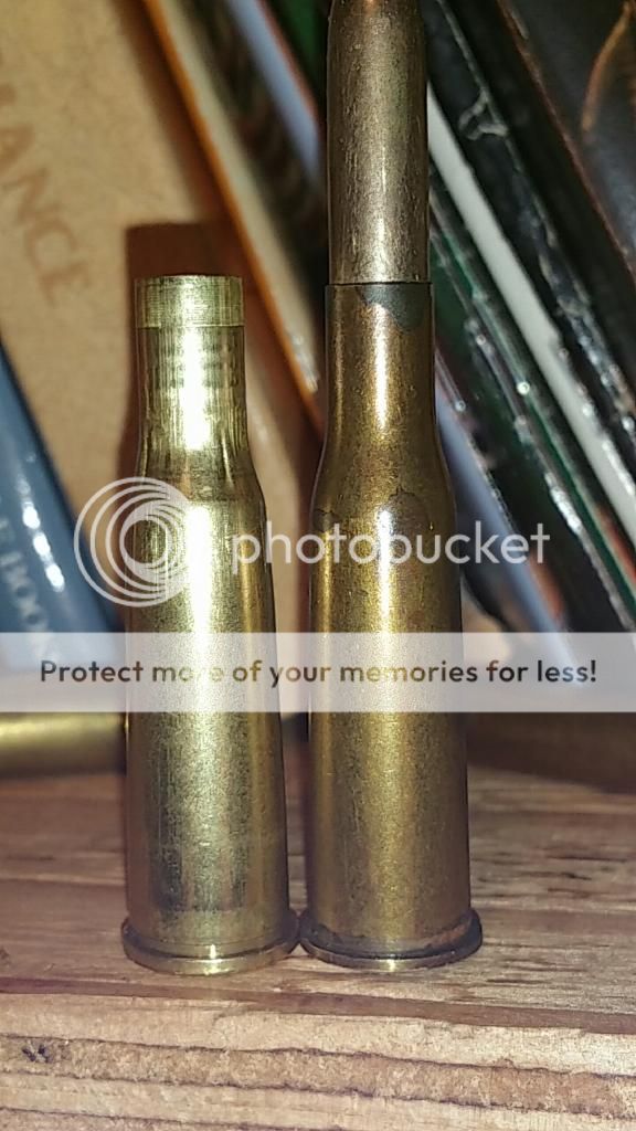

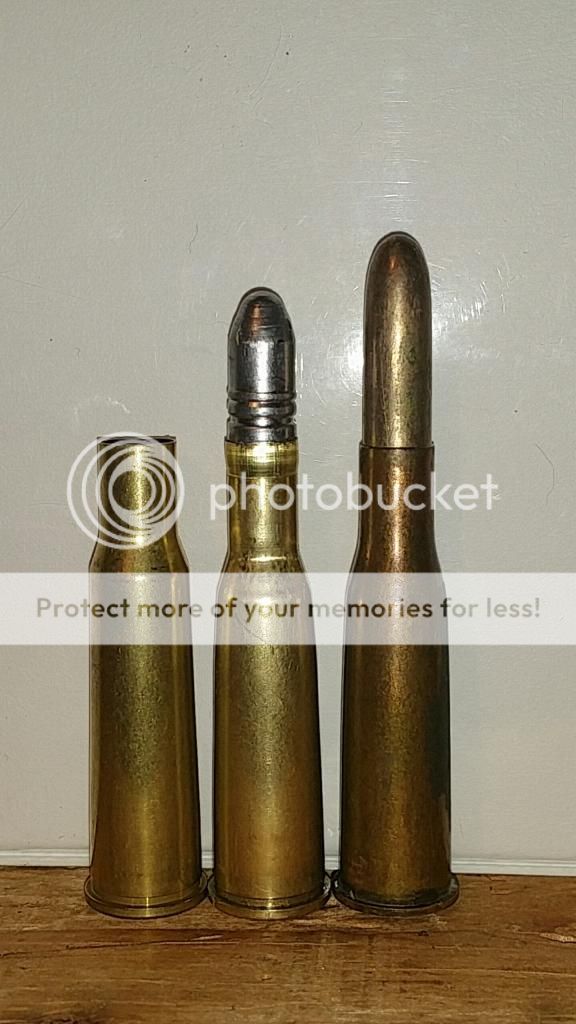

As others have stated brass is the easy part. Take a 348 winchester case and bevel the rim to fit the bolt face. Then I annealed the brass and formed a shoulder with a set of 8mm lebel dies. I then fireformed the brass and that was that.
I partially resize the brass with a lebel die and it works just fine.
Above is left a standard 348 winchester piece of brass, middle a 348 that has been beveled, annealed and sized with a 8mm lebel die. Right is an original 8x56 kropatschek round.
This picture shows a fireformed and partially resized piece of brass ready to load. It looks identical.
