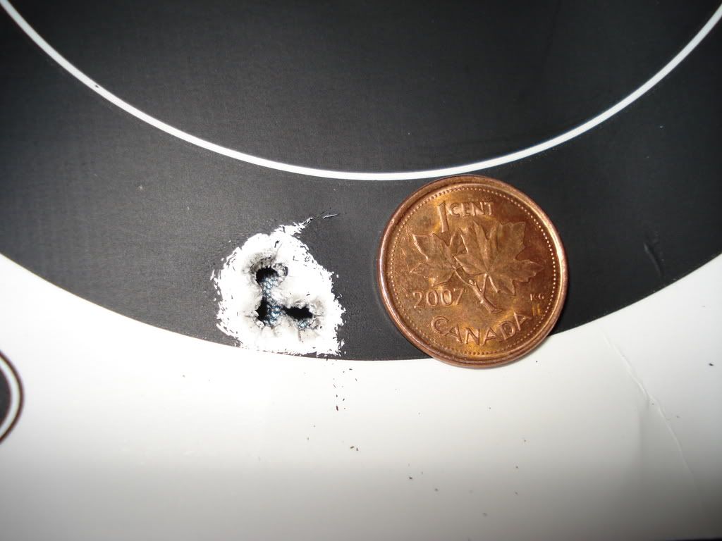

My savage in 22-250 loves the 63 gr sierra pills. And I do mean it really loves them. Here's a 200 yard target
Which
