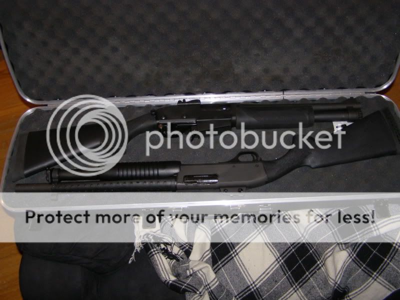

Yeah see thats why i was wondering the length. I just bought a 12.5 Grizz and i put the 12.5 barrel on my norinco mag fed, and the 14.5 barrel (from the Norc) on the Grizz.
Now i wan't the tube on the Grizz to be flush with the end of the barrel. But i think the +1 will be short and a +2 too long.

Our +1 will fit flush with a 14 inch bbl. What u have is. 15 inch bbl.

So how long are the +2 and are they aluminum or steel? As i don't see that shortining one would be too difficult, allthough i don't have one in front of me right now.
Our mag tubes are made from a solid block of steel, they are one piece and would not be easy to make smaller.
But we have some factory remington mag tubes that that are made from steel tubing that have an end cap brased on.
You could heat it up and take the cap off, chop the mag tube to size and then brase the cap back on or used industrial epoxy
