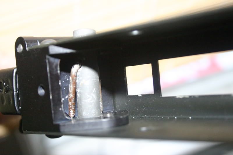

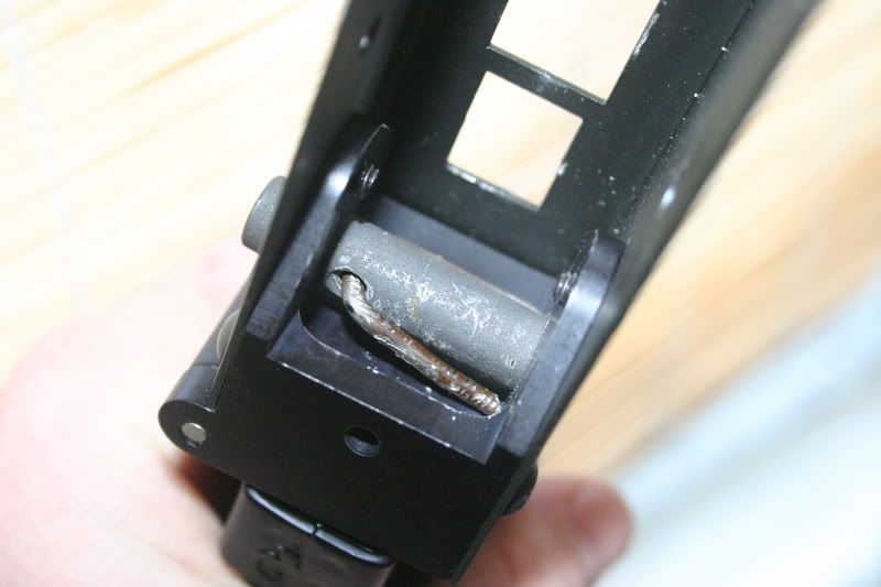

Well I got an 8" krinker kit and was looking at the best way of fixing my folding stock to keep the overall length over 26". I was thinking either of a JB(thanks Rob) weld or traditional weld and then I looked at the spring that returns the release button to its original position. There is a retaining pin in the button's shaft that lets the spring grab the button and return it.... anyway if you have krinker you know, if you plan on getting one you will see it.
So I took out the spring retaining pin and removed the spring, then I feed a 3" piece of coat hanger through the spring retaining pin hole and bent it back on both sides to form a u-bolt. I then trimmed back then ends after determining how much space to allow for the wall of the frame. Anyway it works like a charm, solid and doesn’t move and it keeps me from an ugly buba'ing of the rifle. It took about 15'minutes, here are two pictures of it in (didn't think to take a picture of it before).
