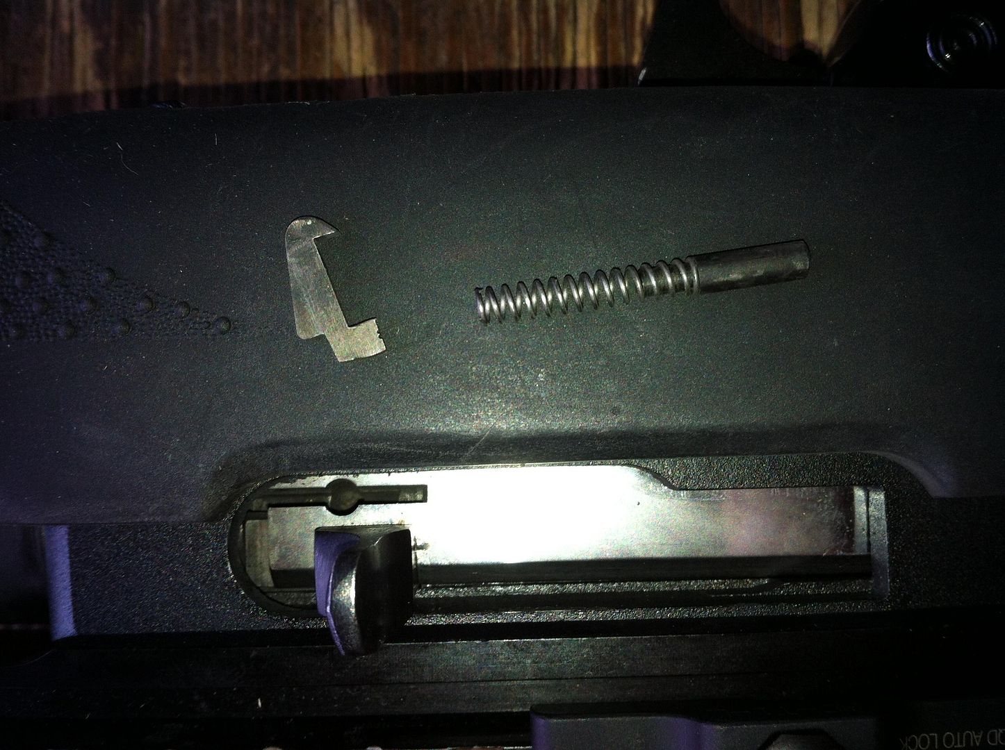

No injury sustained due to careful use of the gun and proper safety equipment, despite the extractor blowing out of the gun at high speed.

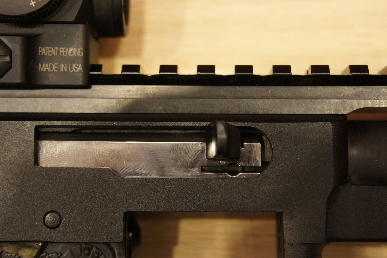

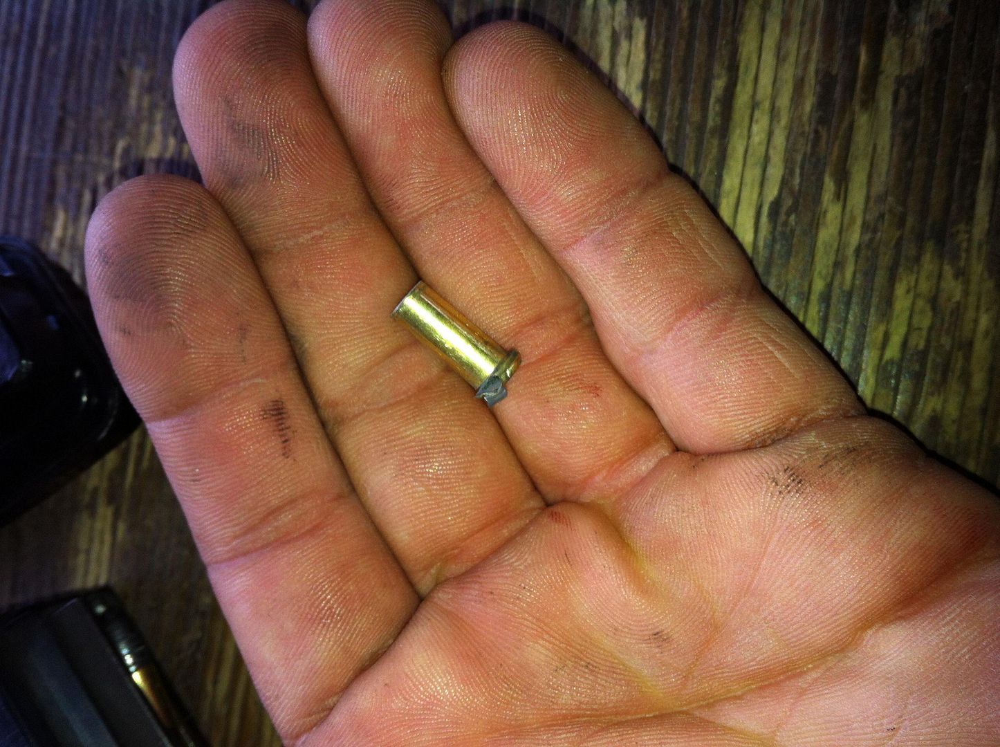

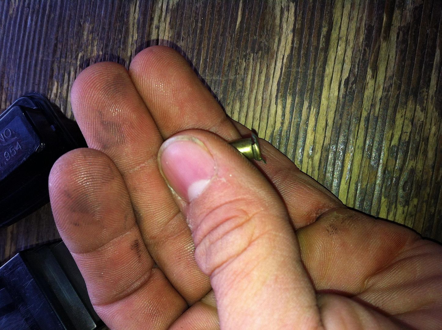

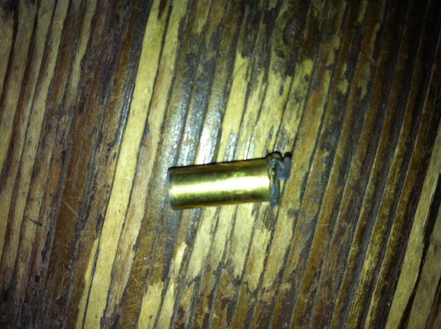

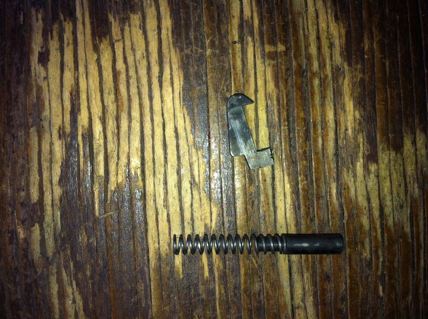

I shot it a total of 5 shots today before it went KB, rupturing the case around the rim and blowing out the extractor and extractor spring. (These were recovered a short way away from the gun with no apparent damage, and fit back in the bolt and appear to function fine.)

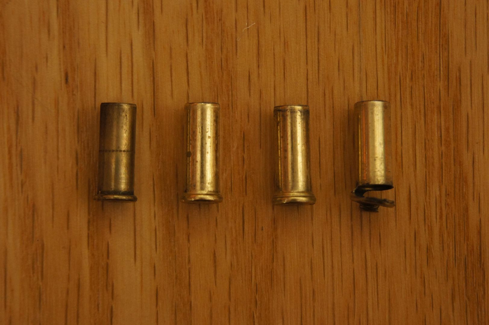

Examination afterwards of the ejected cases from the prior shots show extreme stretching of the cases around the rim, when compared to a standard range pickup .22lr from the range floor.

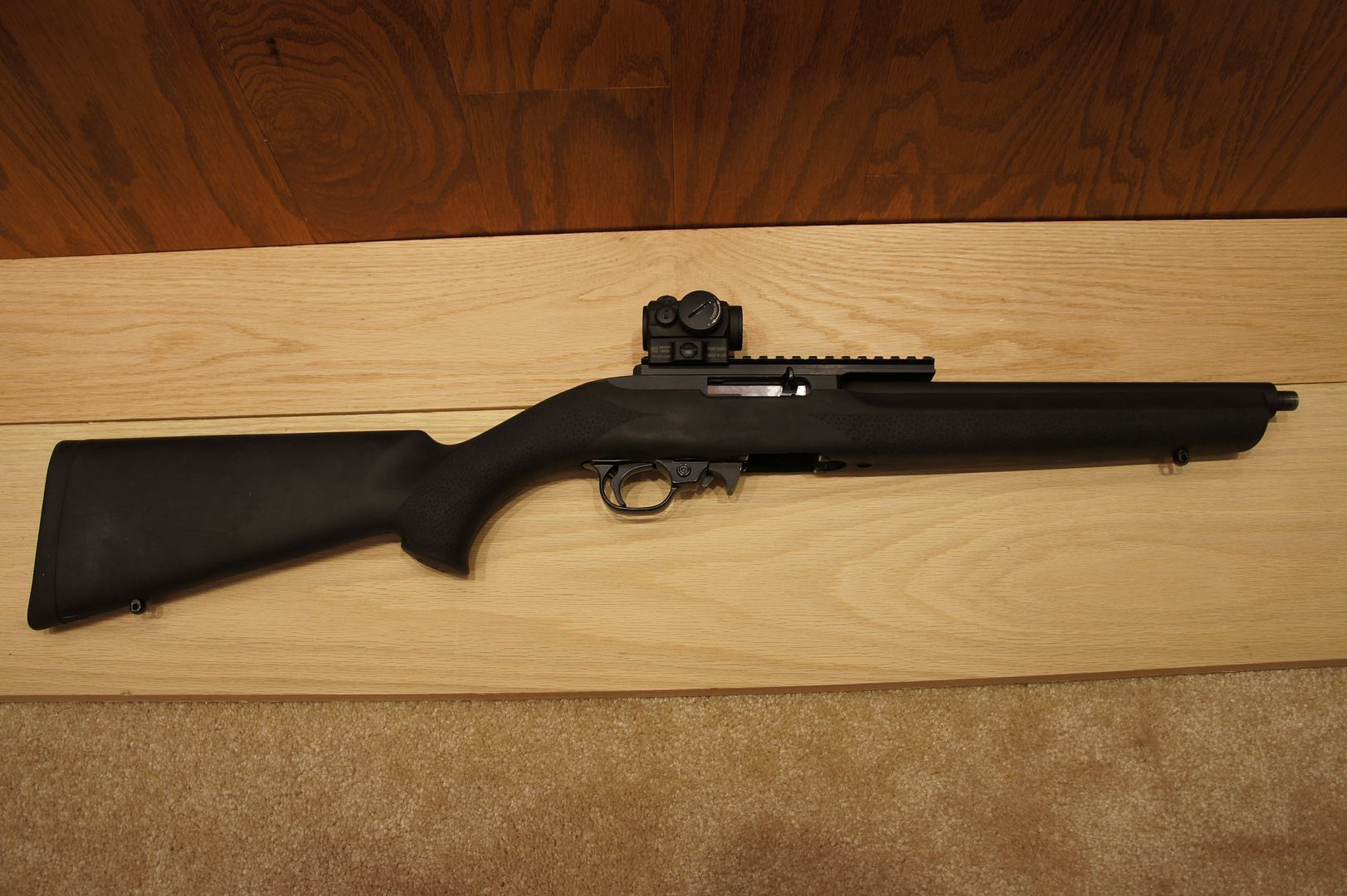

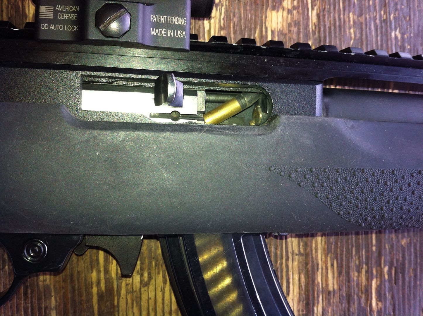

The gun prior to the KB.

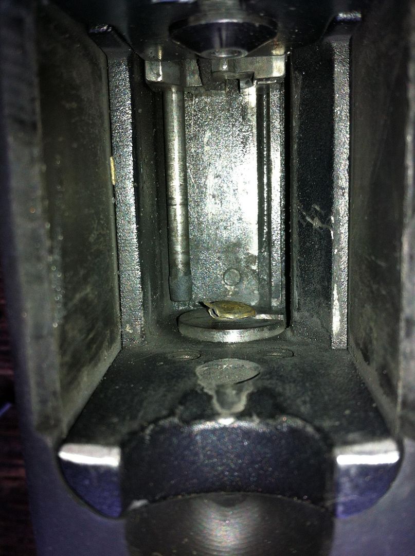

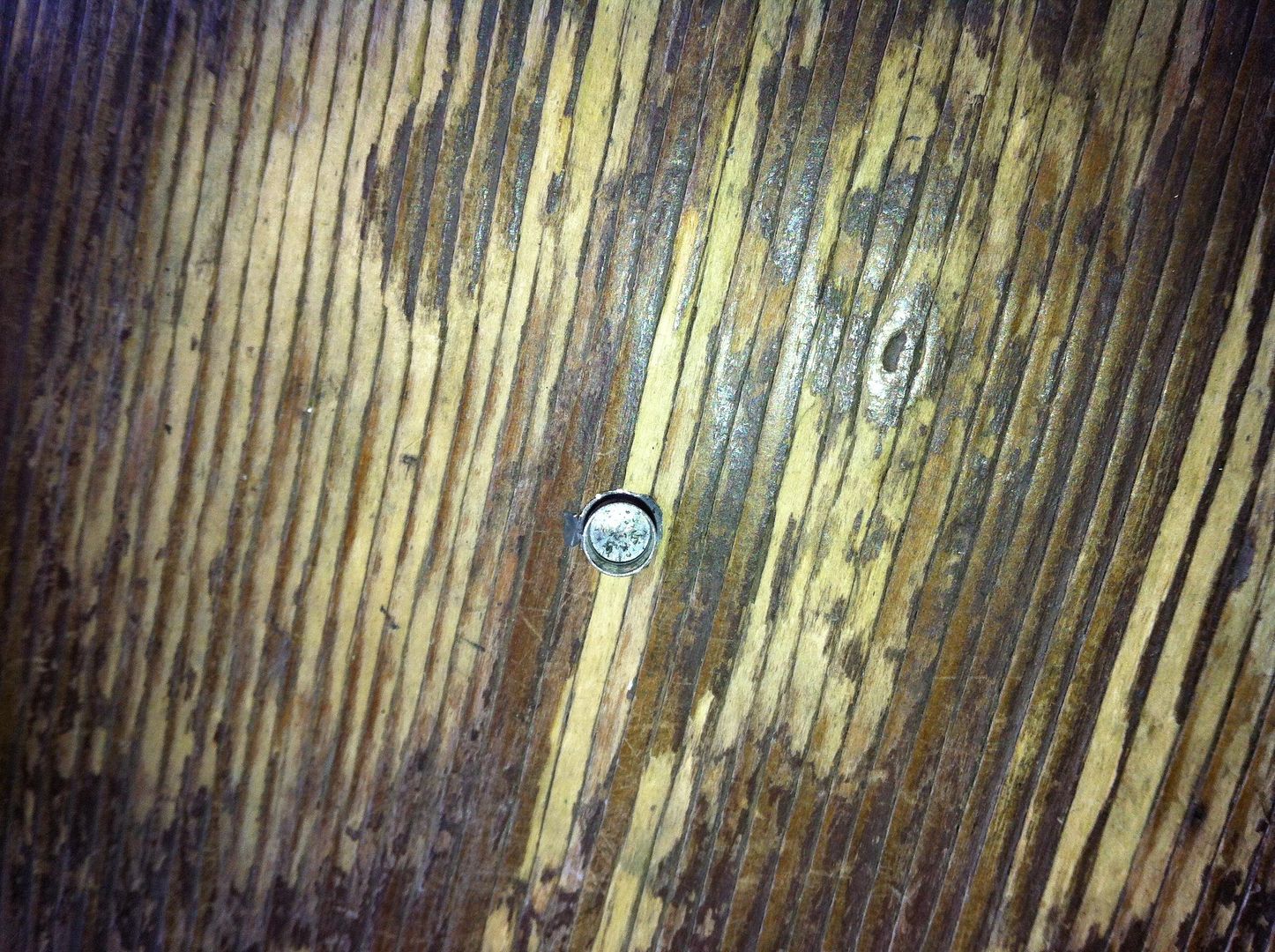

The aftermath.
During disassembly at home.

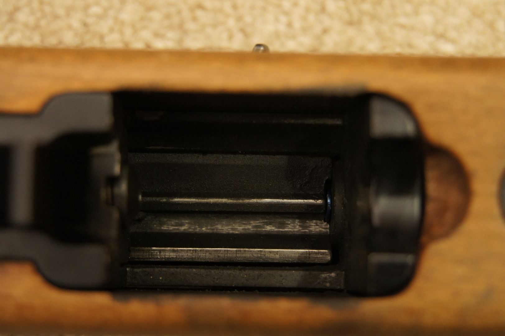

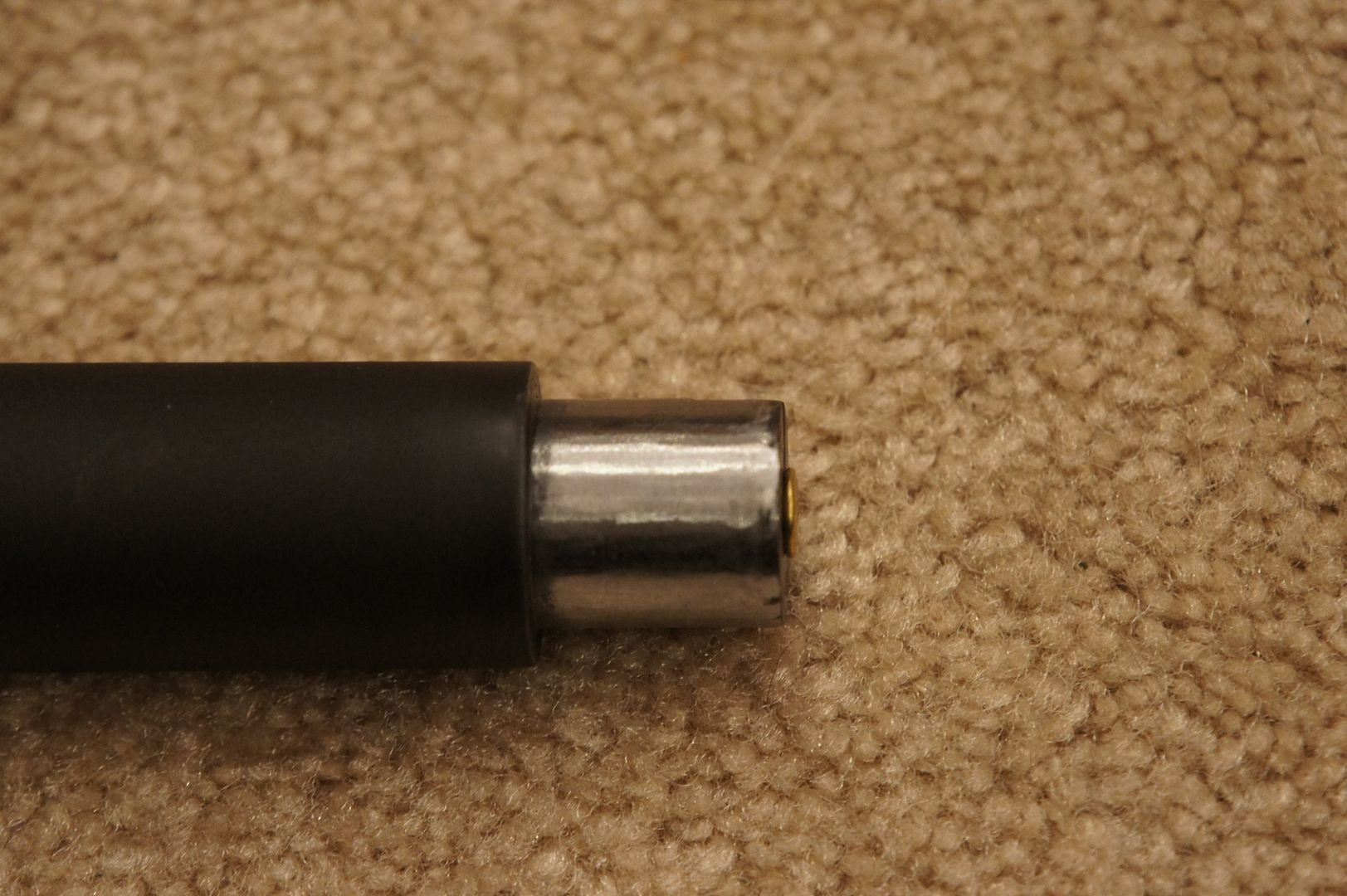

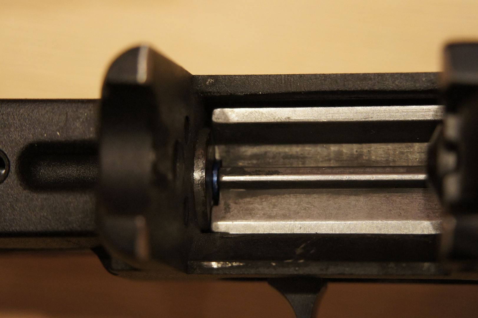

Note the headspace with a 22LR dummy. (Blue dummy, picture taken from the bottom through the empty magwell)
As far as I can tell everything is normal, but let me know if I am missing something.

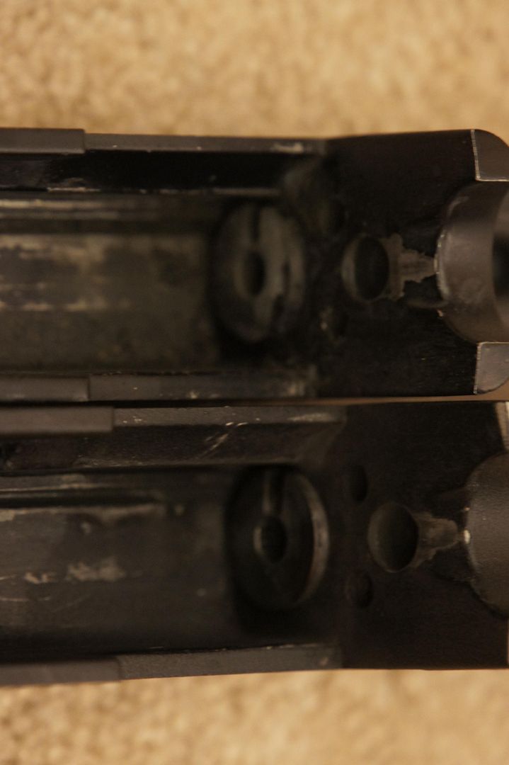

This is the headspace of another 10/22 of mine that runs flawlessly.

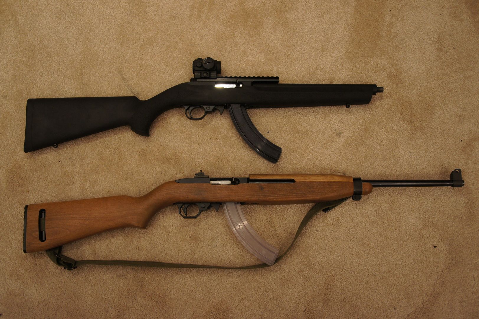

The two guns compared. The one that KB'ed is the top gun.

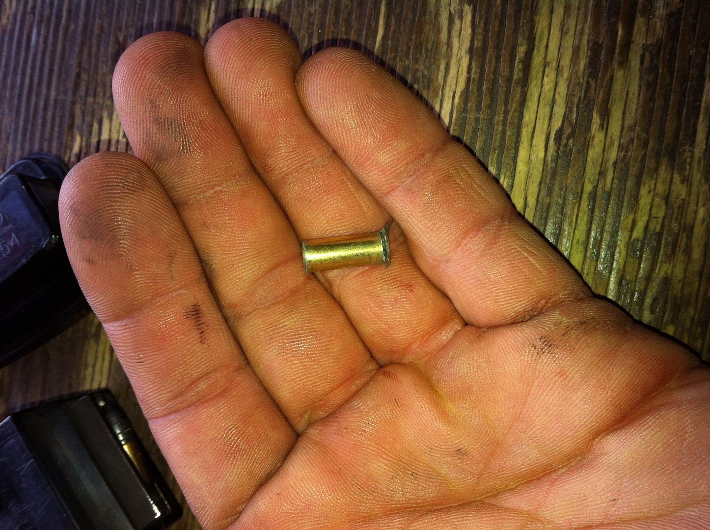

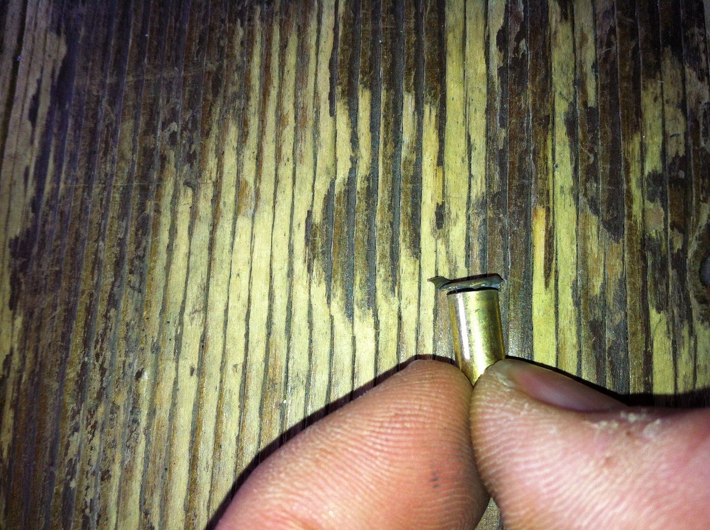

The cartridges. From right to left, a standard range pickup 22LR, two stretched casings fired from my gun, and the ruptured case.

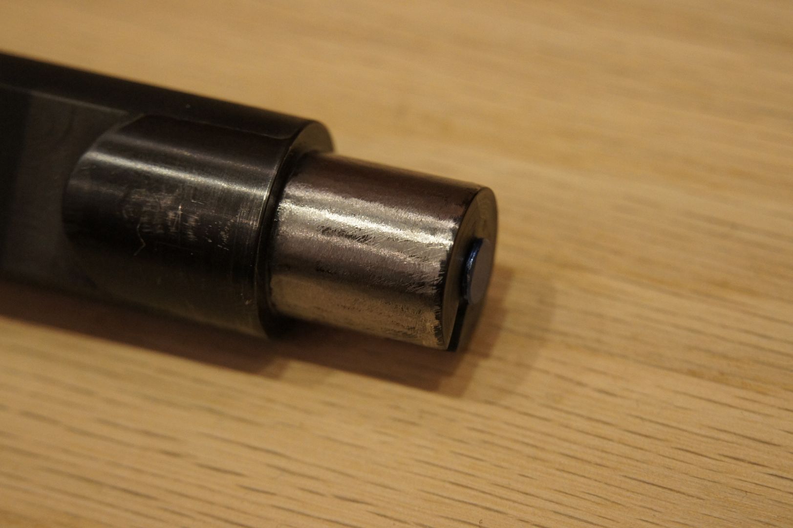

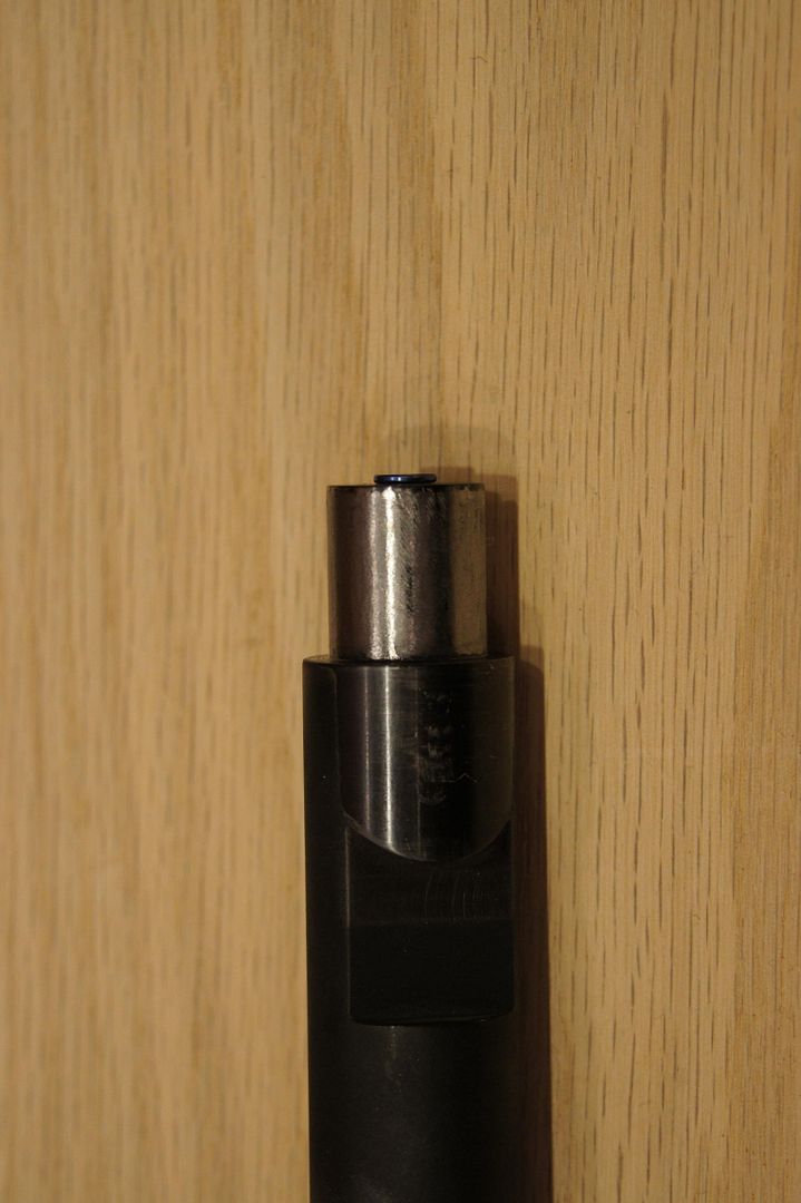

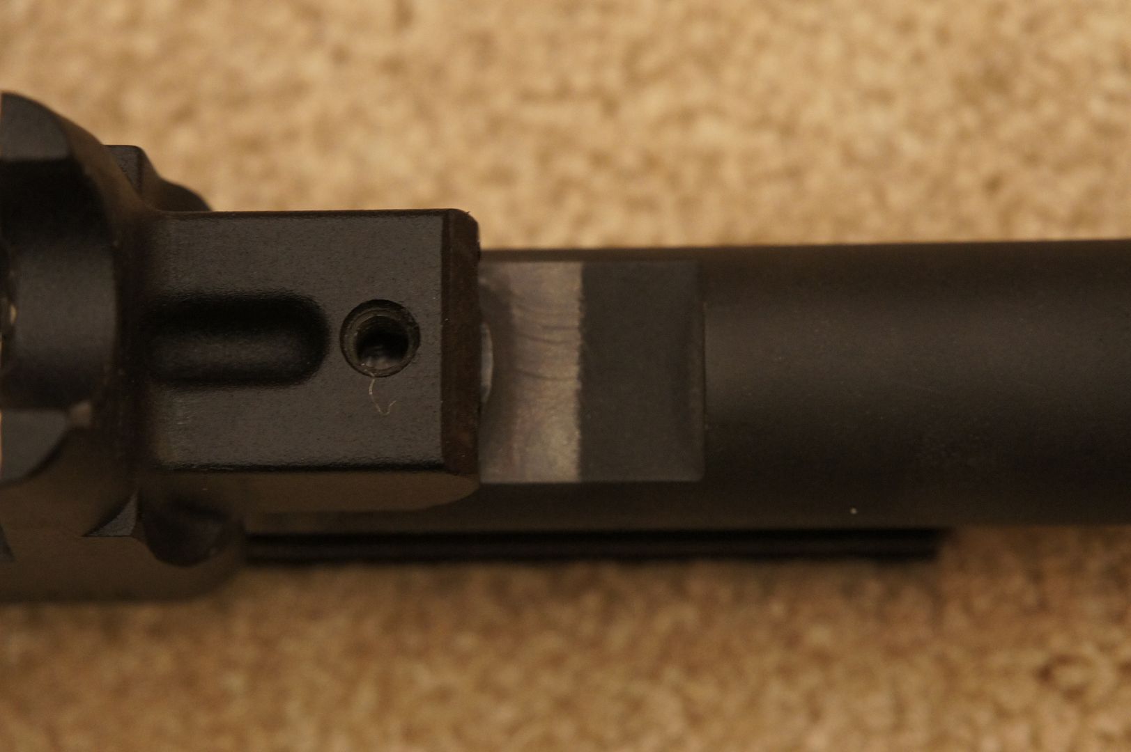

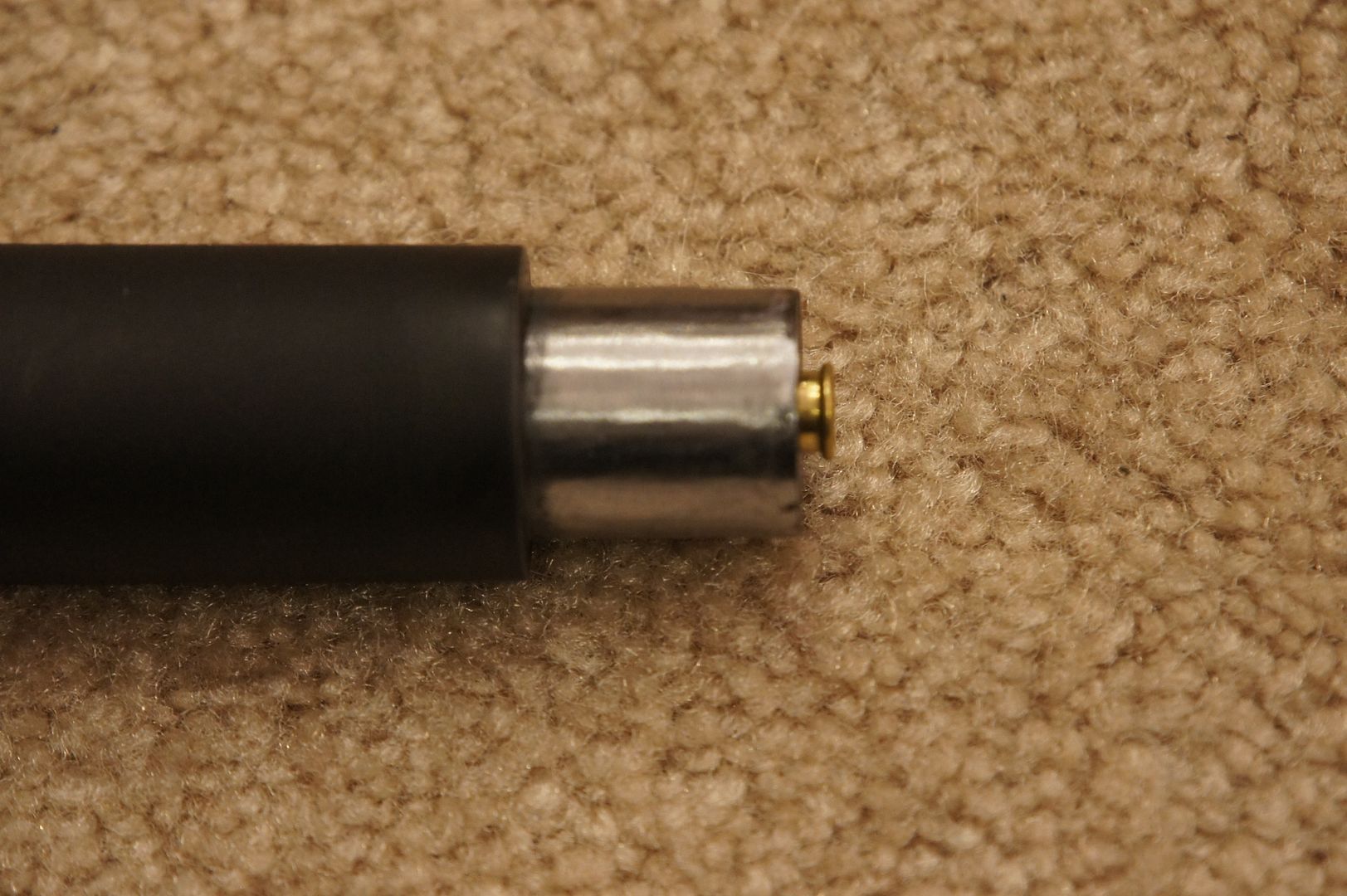

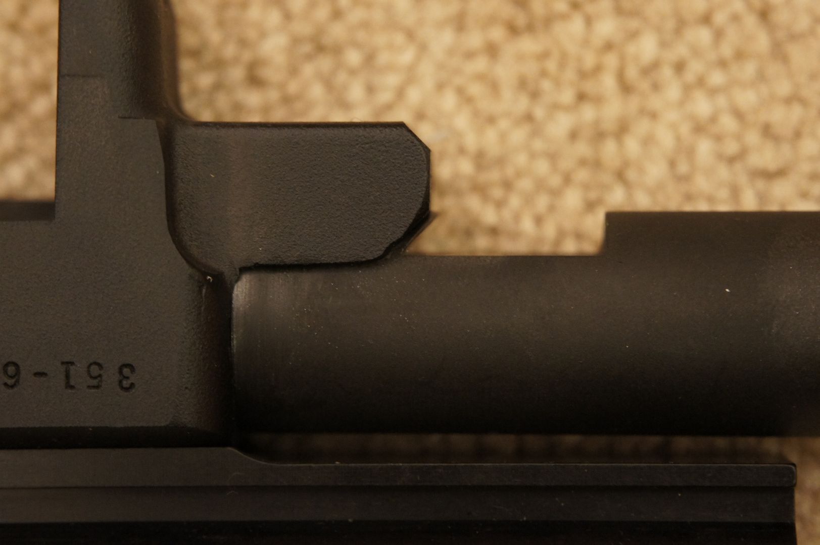

This is the barrel and v-wedge notch on the gun, with the wedge removed. Note how the end of the wedge sticks out just past the end of the receiver wedge slot. Is this normal?
Help me out here, I have no idea why this gun continues to rupture cases despite rebuilds. What am I doing wrong, or what is wrong with my equipment?

Been tearing the gun down and measuring everything I could for the past few hours since I posted, and this was pretty darn close.
Turns out the chamber was just a touch too tight to allow for most brands of .22LR to chamber fully, allowing the 10/22 which has no preventative measures to stop the hammer from falling out of battery, to fire the cartridge about 1/16" to 1/8" out of battery, causing the explosion.
This was not evident until I took the gun apart and tried dropping a live .22 down the barrel instead of a dummy. The dummy did not show what the live cartridge did.

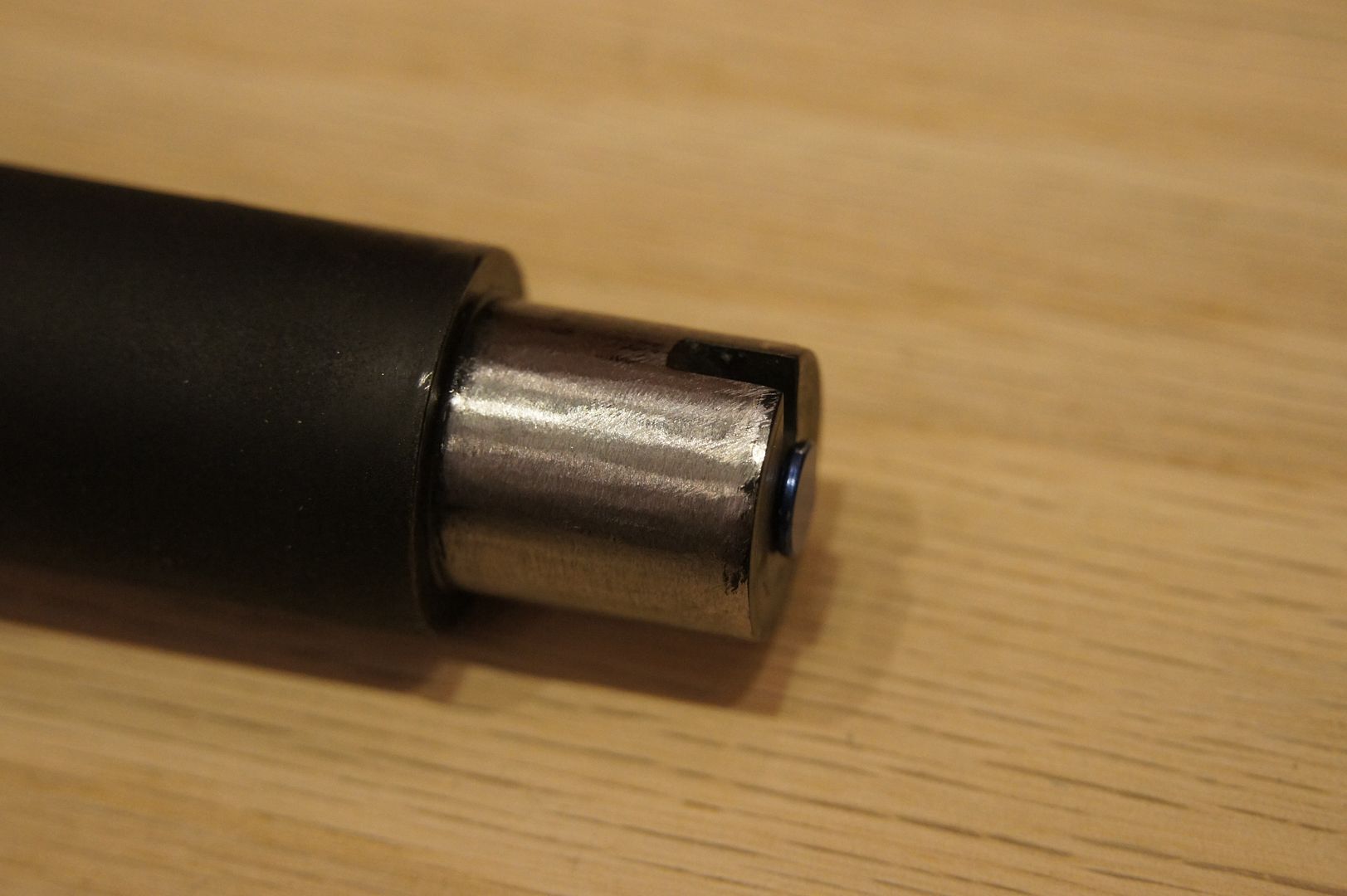

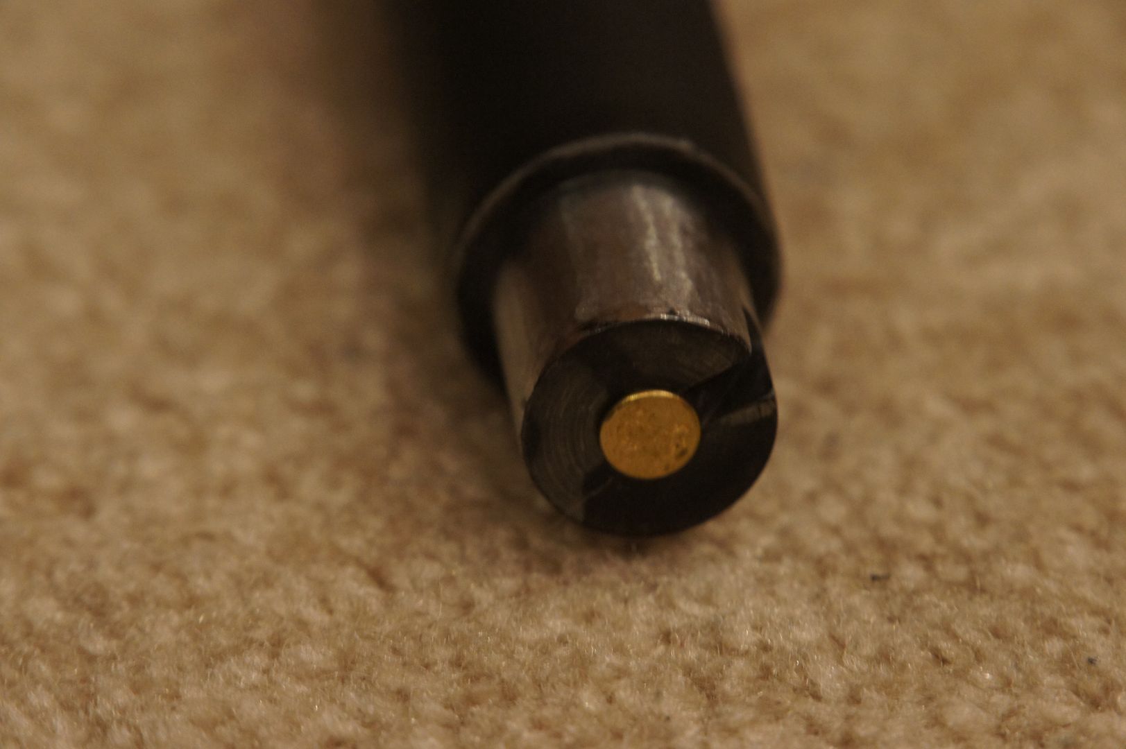

A bit of work with a standard .22lr reamer (As opposed to the .22lr match reamer that I believe was what was originally cut in) and some polishing and voila, every brand chambers perfectly now.
Before...
After...
And the rifle next to a 10/22 M1 Carbine.
