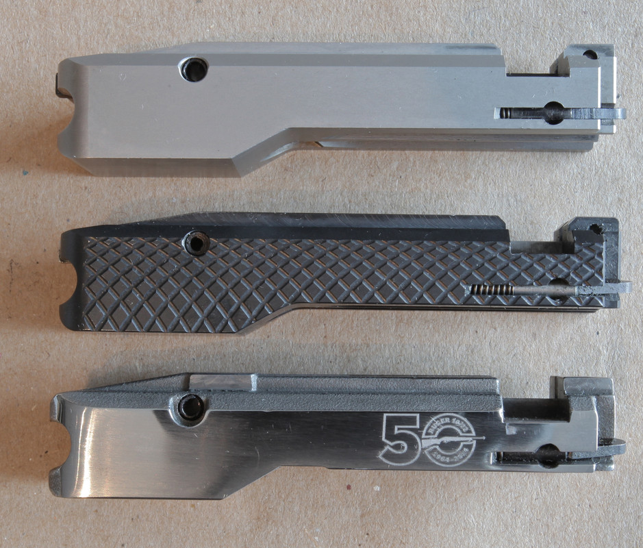

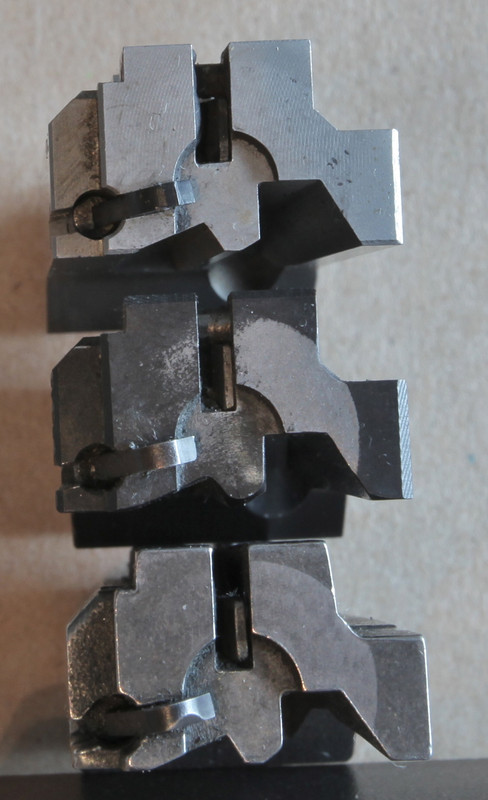

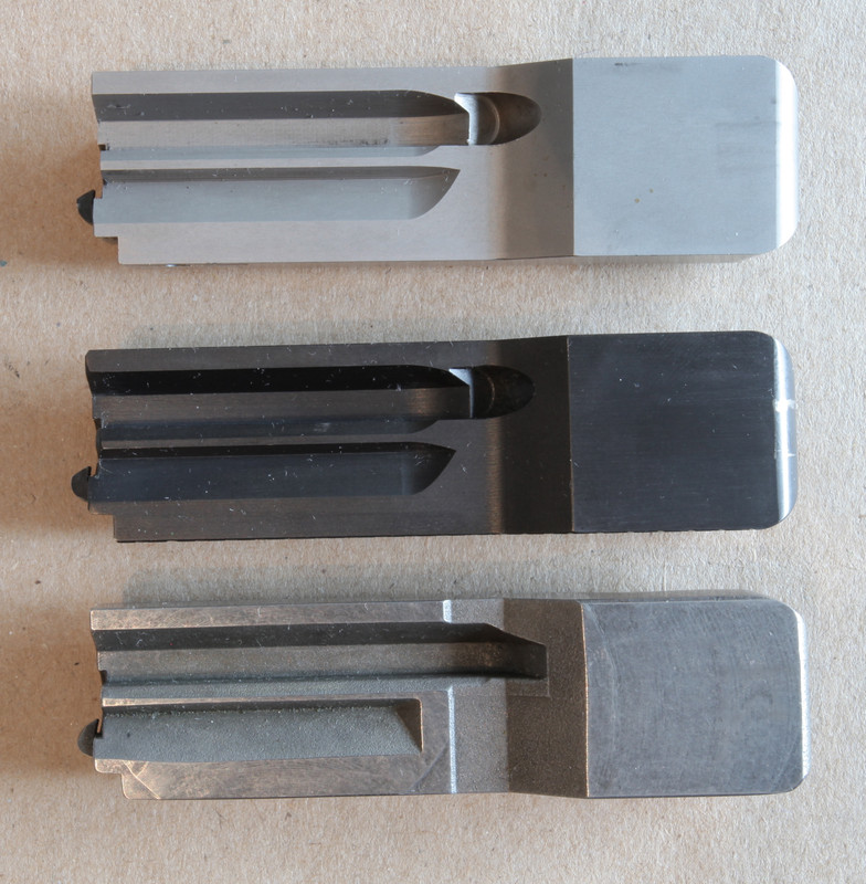

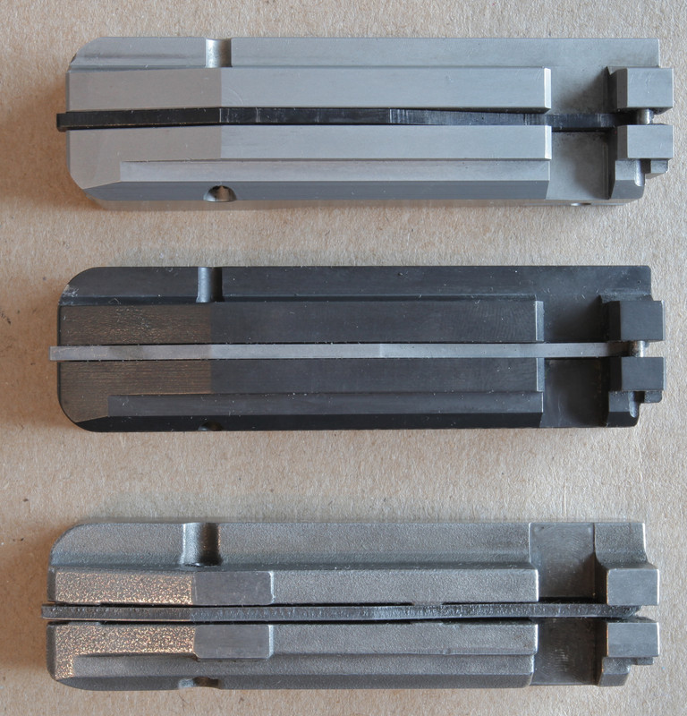

I recently had the opportunity to purchase a lightly used Dlask 10/22 bolt for a reasonable price. I didn't need another 10/22 bolt, but I was curious to examine one up close and compare it to a Kidd bolt. Here are a few comparison shots:
top: Dlask (satin silver) , center: Kidd (black scallop), bottom: Ruger ("50 th" with Volquartsen extractor) ....
You have to look fairly hard to find the differences between the Dlask and Kidd bolts. I am planning to do some 50 yard accuracy comparisons between the 3 bolts in the same rifle, using the same ammo, but don't anticipate any measurable differences.

Excellent comparison photos of the bolts are very sharp. I can't understand why add the cross pin above the firing pin? Is the firing pin known to jump up? Wouldn't the charging handle keep the pin from lifting?
