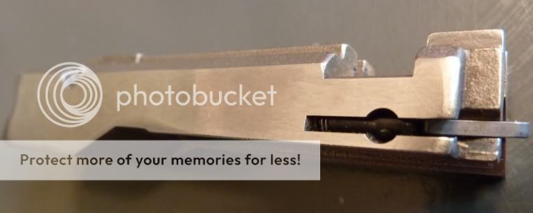

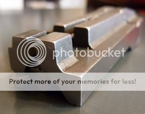

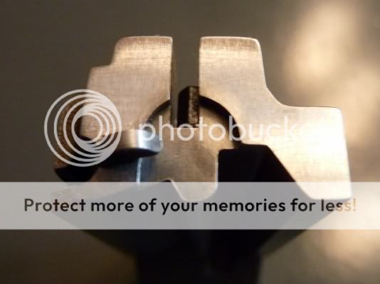

Here are some after pics, nice and square after grinding. Anyone else checked theirs for taper? How about case hardening, think is needed? Ordered a new extractor from Hical today, I now know where I will be getting my parts from if needed, great experience.

I did the back radius as well. Mounted an angle plate at a right angle to the grinding wheel and rotated by hand. The pin is definitely next, I want to wait until next week when I am back at work and can use a 3/32 carbide end mill.
I have not used rouge on it yet but I have debured and polished it, along with all the stamped trigger parts with a rubber deburing stick and stones. With the overtravel screw, stoned hammer, bolt buffer, soon to be titanium extractor and .055 music wire return spring its really starting to feel nice. Total cost so far $25.00.
