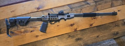

10/22 build
Yes .They do not fit Receivers that over hang the barrel , such as SBI , Dlask. Works well with Ruger Receivers.
In theory that overhang could be machined off and then it will fit in the chassis.
Either that or modify the chassis.
Either one would pain me a little but it is a necessary evil.
