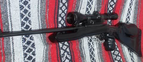

My conversion consisted of, first spending a lot of time reading as many posts from as many forums and sites as I could. I tried to do as much as possible on my own (cheap). I had a standard barrel sitting around so I sent it to Elwood Epps in Ontario for relining. Cost 150.00 plus shipping. I bought a magnum cocking lever assembly from midway for 6.00. I cut the magnum lever down to the correct length and then welded and addition onto the handle to add weight and size. I used the magnum spring for more resistance. Not much else was done except for some of the standard bolt mods, champher the rear of the bolt, truing the face, pinning the firing pin and adding my own nylon buffer.
I was surprised at how well everything went together and when I test fired the gun out in the garage for the first time IT WORKED!! I had no case splits or buldged heads.
I have only fired 50 rounds thru it so far and every one worked, no feed problems or failure to eject.
I made the mistake of not taking pictures as I went along but here are some of the completed gun.

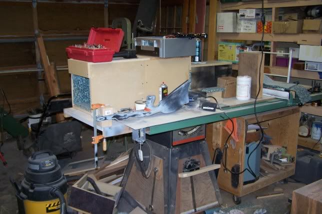

My test rig.
