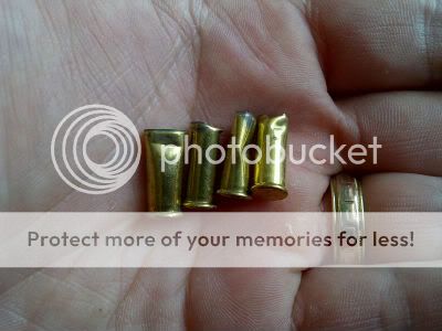

Wondering if anyone else has had these issues with their 10/22. Mine only has about 400 rds through it and when I was plinking today started getting jams...noticed they were empties that had failed to eject properly.
I've attached some pics. Any recommendations?
Clean and lube the receiver internals.
Clean the barrel (don't lube).
When shooting, do not free-recoil,
but hold the stock solid in your shoulder.
You will be fine.

First 500 rounds through mine were ok with a few of those stove pipes, about 1-5 every 25 rounds. This continued until about 4k rounds. it now functions perfectly.
However it always worked perfectly with quality 40grain ammo. cheap stuff doesn't have the umph to work it properly. Mine still does this with 36 grain ammo.

Gonna try cleaning it first to see if that works, never thought a 10/22 would be that picky, but you never know. I thought the ammo I was using might have contributed to the problem too...Federal 36gr (Walmart's finest). Once I've finished those boxes, I'll get some hotter stuff to see what kind of a difference it makes.
