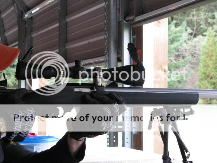

Hey everyone,
I was at the range today shooting my scoped 10/22.
Recently I put a number of VQ parts into it, including: Buffer, Extractor, Hammer (with springs), Takedown Screw, Extended Mag Release, and Auto Bolt Release. Today I had some small trouble with two areas.
1) The factory mags have always been a little tough to get out of this gun. With the old-style non-extended mag release, they came out easily enough when I put my thumb on the rear (bottom) lip of the mag to pull it out while simultaneously pressing the mag release. With the extended release I can't get my thumb there, so it's tough to get the mag out. Grabbing it by the front lip doesn't help.
Is there any way to make it easier to take the mag out? I couldn't find anything in the 10/22 tips and tricks sticky on this. For now I've put the old style mag release back in to make my life easier. I suppose I could look for some 10 rnd BC mags.
2) The VQ hammer came with a hammer spring, which I installed with the hammer. Today I was shooting Dynapoints and had about 1 in 15 rounds misfire. Before the Dynapoints (same box) had always proven reliable. I've read that the VQ hammer spring is weaker than the stock one, so for now I've put the stock spring back in the gun. The trigger still seems nice; it's hard to tell but maybe it was a tad bit lighter with the VQ spring.
Anyone else experience this problem?
Thanks for any comments you might have!
