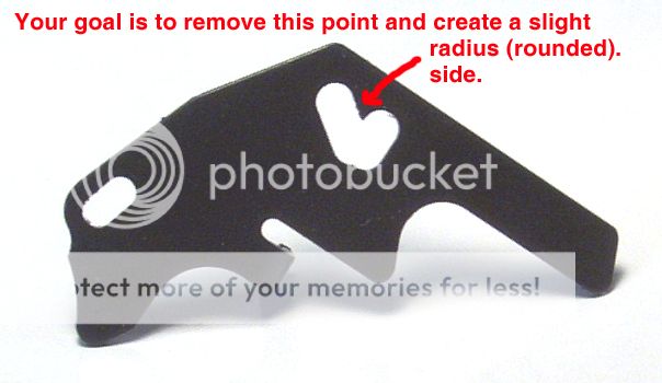

I bought a 10/22 Ruger with a full wood stock a couple months ago. I don't know the proper name for it, but the lever on the left side that holds the bolt open for cleaning, etc. is a Major Pain to release. Is there a aftermarket part that replaces this ?
You can either purchase an auto bolt release for around $10 on ebay, or can simply just modify your old one by using a dremel..... Fabsports, a site sponser has them for $19.99
http://ruger22.com/newpages/plate.htm
That's Great. Looks pretty simple. I was planning to change the trigger, but it seems pretty good, maybe someone has already done something to it. I definitely plan to change the mag release. Thanks Again for the info Guy's :cheers: Jack
