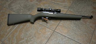

I went with the factory 16" carbine barrel on one of my 10/22's.
It's very 'handy' & been very happy with it. Set it up in a green Hogue stock & Bushnell compact 4x scope.

This is very close to the same set-up that I'll be getting to start. Glad you like it. Love the carpenter's pencil in the trigger! ;)
