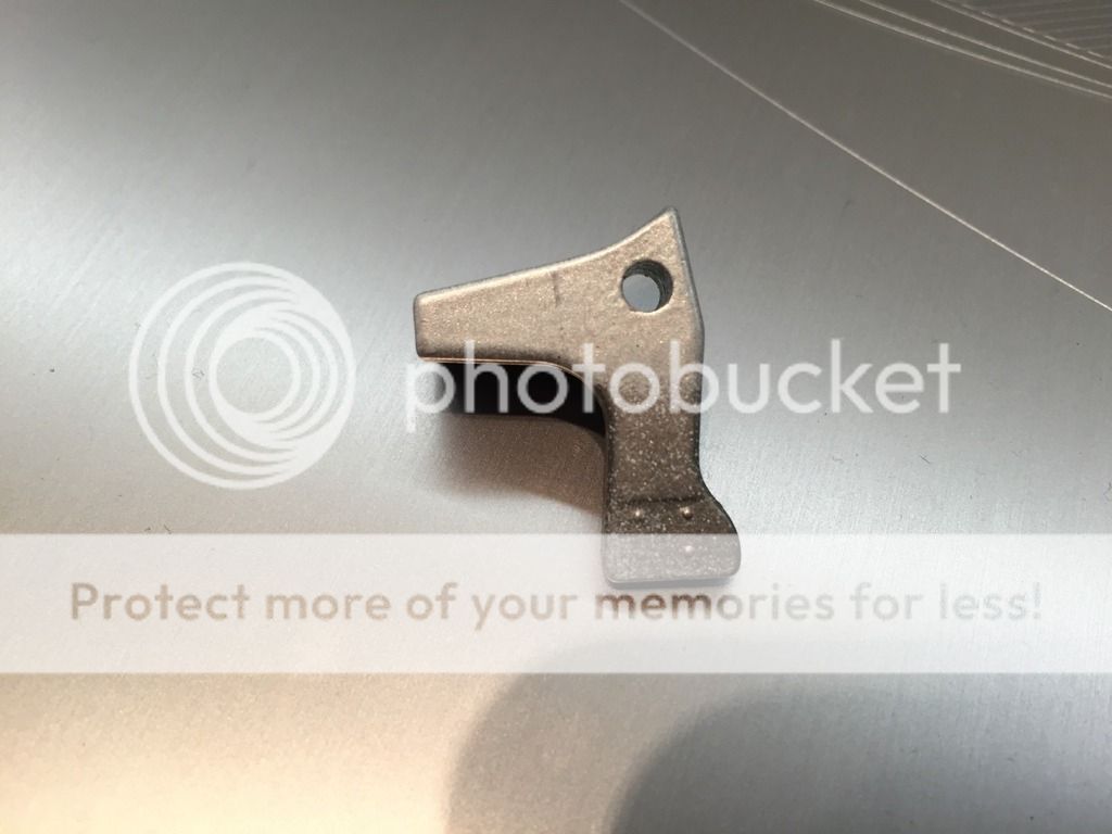

I've owned a 10/22 for a few years now and it still stove pipes on the regular. Lately I've been trying to fix the problem and installed a Volquartsen extractor, polished the bolt+trigger, cleaned the mags and chamfered the bolt.I also gave it a 100% clean. Also have tried firing high velocity rounds.
It still stovepipes!

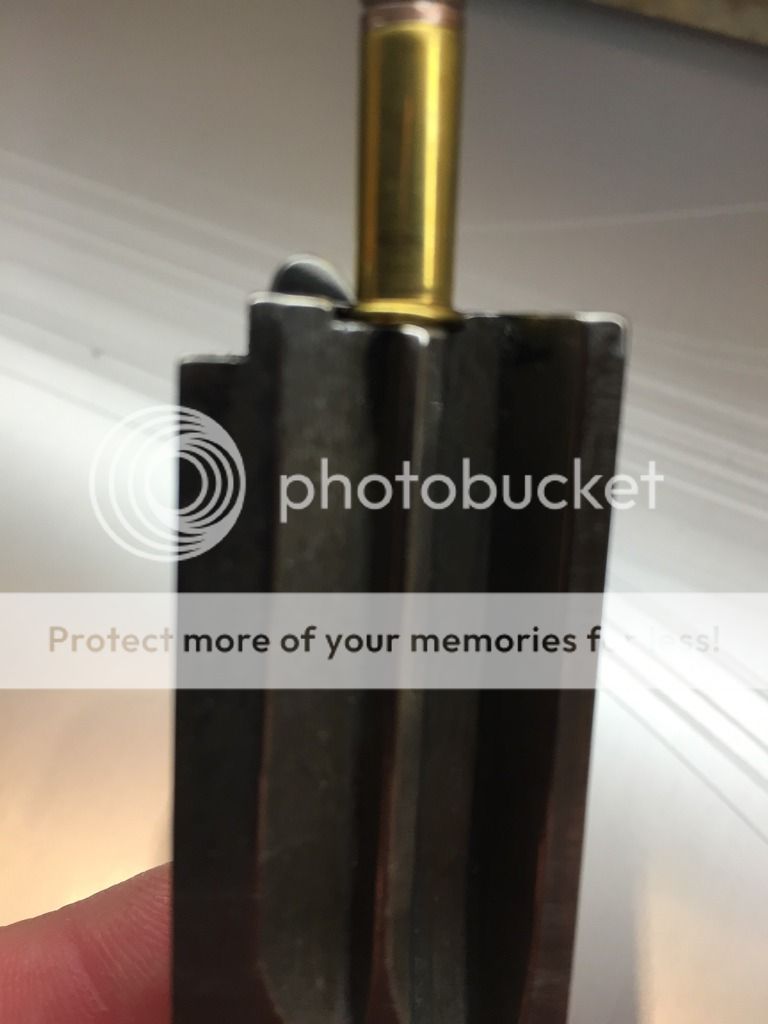

Below is a pic of a gap between the casing and extractor... Could this be the problem? Maybe with the bolt or the plunger?
Any other ideas?
Thanks :)
Bonus points: I understand older 10/22s have flush mag releases, can anyone post a pic of a close up of one? I'm considering modifying a stock one on for hunting!
It sure looks like that extractor isn't installed properly or there is something wrong with the bolt itself. When you installed the new extractor did you really clean out the groove? I blast mine with brake cleaner, a pick and compressed air. Grit and crap builds up in there pretty solidly and takes a little work to remove. Since it has been doing this all along did you get all the packing grease out of it in the first place? In most of the 10/22's I've troubleshot over the years that groove has not been cleaned properly.
Extractor is definitely screwy, they can be a little tricky to seat in the groove, and debris can get in the groove as mentioned above.
Jimminy Crickets that extractor is grabbing way high!

Well, I gave it a good clean again and it still sits way high, it almost looks like the hole isnt perpendicular with the length of the bolt, is that normal? I just did an order with brownells and I dont really want to buy a bolt on its own..
I'm thinking about taking the stock extractor and heating it up and bending it down. Thoughts?

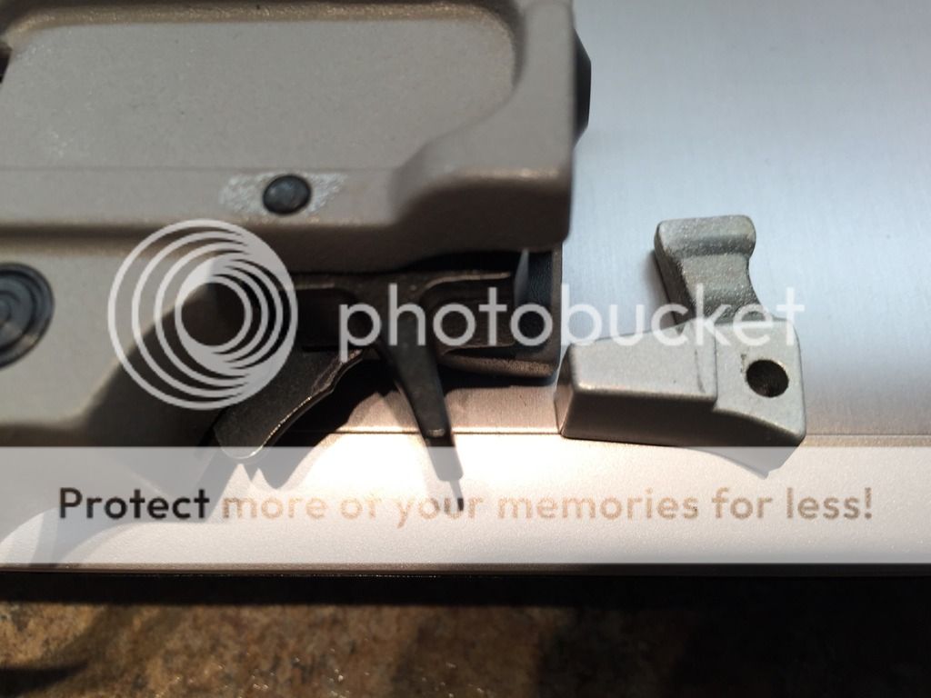

No tips for installing them but here's a measurement for you to compare yours with and a couple of pics of the face to show the extractor grooves location.
I put a rare earth magnet on the face and measured from that to the hole. I guessed a .025" gap when I saw your pic in the original post, I was only only .005" out. I would say bad bolt. I would contact Ruger direct, dealing with Locations Snapshot (Ruger's Canadian warranty depot) is a pita most of the time. Send them a link to this thread after you post a pic similar to this one and see what they say.
Well. live and learn, a tale of 2 bolts:) I took a bolt out of another gun just to compare the 2 and found some interesting discrepancies but one very important similarity.
The 2 together, note the totally different machining. I'll call the top one bolt 1
Bolt 1, 2 measurements using the magnet
Bolt 2, same measurements
So I guess the .340 is the important measurement. What's yours at that point?

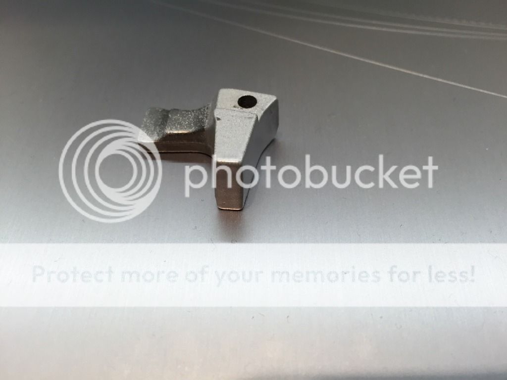

Measure from the bolt face to where the cartridge sits. Mine are within .002" of each other .046 and .048. Then compare to where your hole is at like my measurements above.
my bolt
.040 from the cartridge face
0.304 from the hole to front face
=0.264 from hole to cartridge face
your bolts
0.340 - 0.038 = 0.302
yours 0.302 - mine 0.264 = 0.038" = 0.9652mm
dang close to a millimeter, that would do it!
Thanks for your help elimsprint you are a champ! I'll shoot ruger an email and we will see what they say!
