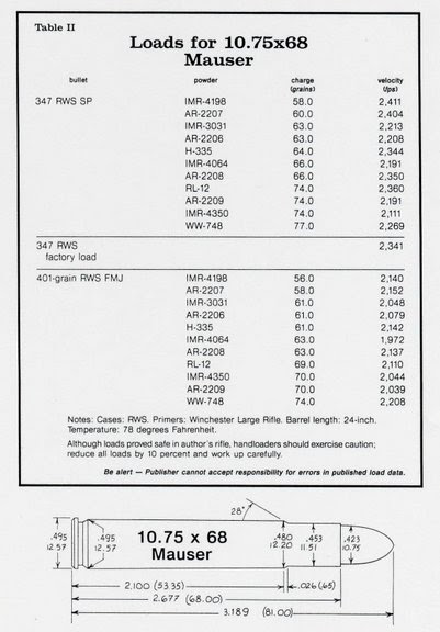

If you read French, older Malfatti Manuals had load data; not the 6th edition as I just saw. Gheerbrant's Manuals do have the entry.

The 10.75x68 achieved a poor reputation mainly due to the poor penetrating bullets of the day and how light the grain weights were (I think a 347 gr projectile?). It would be my guess today that with better powders and modern heavy bullets, like the 400-grainers you're considering, it would essentially equal, or come close to, the .404 Jeffery which was designed to replicate the .450/400 in a bolt action repeater. Not sure I know of load data but I'll see what I can find in Boddington's book about it.

In a good bolt gun like a 98 Mauser you can safely get similar ballistics to the original.404 Jeffery loads. I think I have the loading data somewhere, I’ll see if I can find it.

seems the varget become an interesting option again. the 401 grains i d like to see the coal there is a chance of not fitting in a regular the reason of the 347 grains limitation in the old days.
