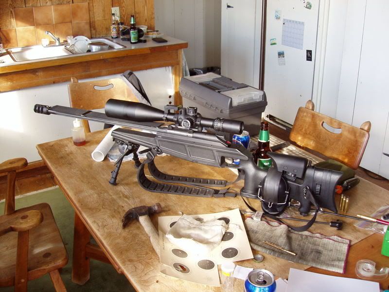

What I meant is that the Blaser R93 in 6mmBR is not an F-class Rig. Now that statement is true. I don't deny the 6mmBR cal. is of F-class capabilities. Check my original post. I was talking about the Blazer R93 in 6mm BR.
Have a look at this pic and tell me if this is an F-class "legal" rig.
http://i135.photobucket.com/albums/q149/sniper3870/P1070232.jpg
Sniper767, over!
Take off the brake and it is. It should be able to compete with most rifles on the line or someone has wasted a lot of money! Regards, Bill.

Sniper767, I agree with you that the LRS2 is far away from what an F-class should look like, but who care what it looks like!:p last time I check the goal of the game was to put the bullet in the middle of the target and it does the job quite well:D
As for the 6mmBR not being a competitive round for 1000 yards, all that I can say is, if my 13 years of competitive 3D archery as tought me something it's that speed is nothing without accuracy;) :)
That is a very nice looking rifle and for F(TR), it DOES look like many rifles when you account for all the adjustable combs and buttplates. I like the foreend too :).
Just ditch the muzzle brake and add more weight. 18lbs for F(F/TR) or 22lbs for F(O). Personally, that rig in 308 or 223 would be awesome off the bipod. Just way more money then needed.
Jerry
