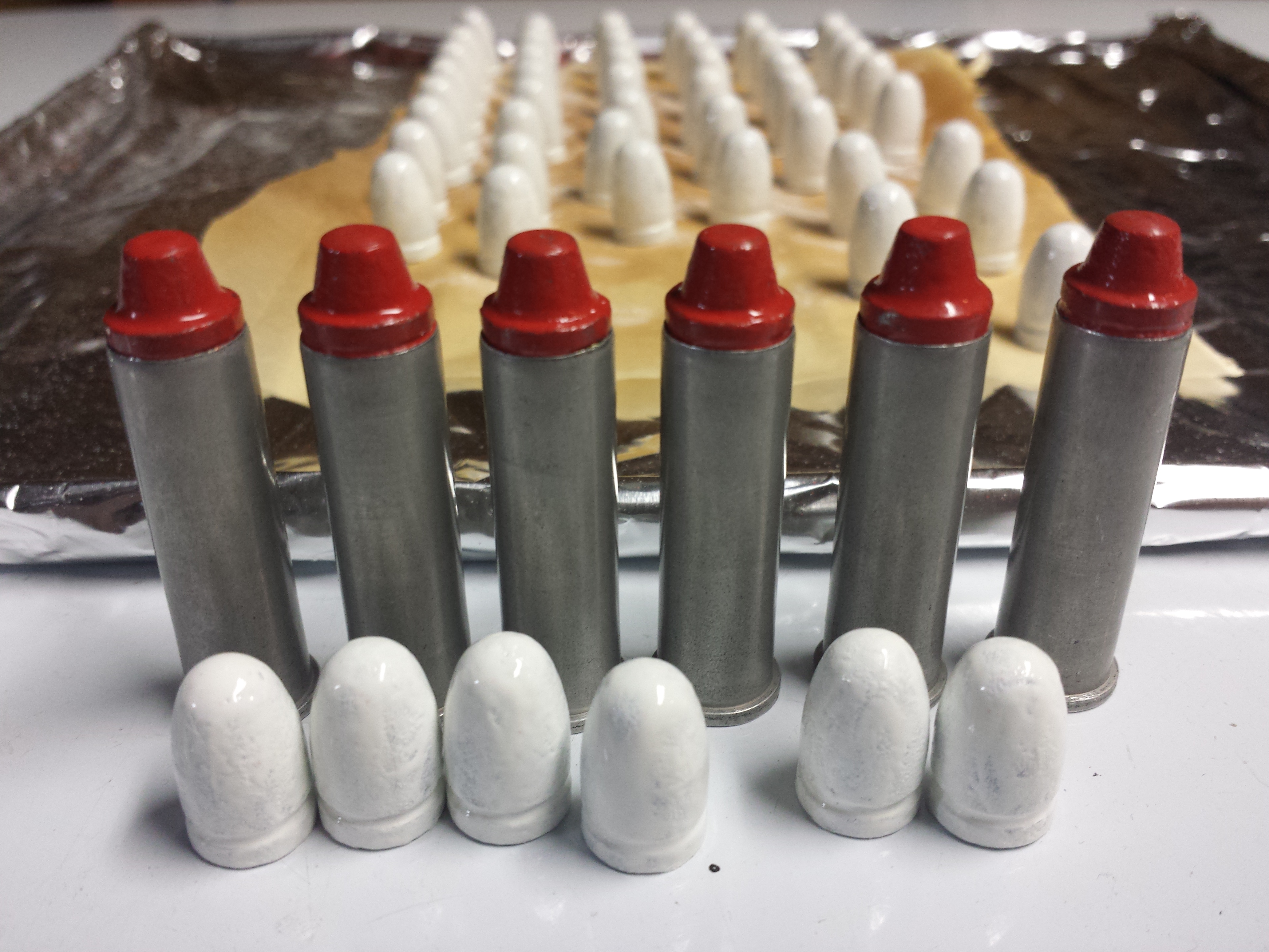

Here was said picture. I have powder coated them for use in the 357mag at full loads of h110 and didn't have any leading. Once my new bench is setup i will get around to making more.
(yes, those are aluminum cases)
