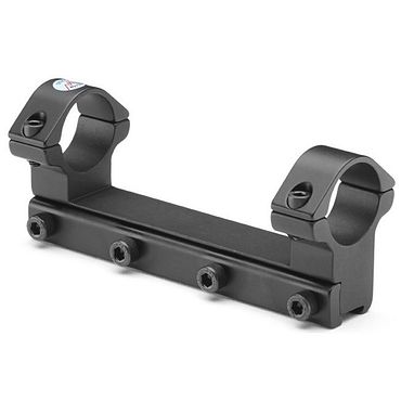

I see a SportsMatch 20 moa base for 11 mm dovetail on an airgun site
but it looks adequate enough for use on a .22
has anyone had one in use ? how did work out?

As Grantmac says, if they do the job on an air rifle, they will more than do the same on a rimfire. Spring piston air rifles have much more recoil than a rimfire. I've used SportsMatch rings, both one and two piece.
The one you're looking at is probably the one shown below. The only concern is that the length of the base is 120mm (4.7"). If it covers the ejection port, it will probably interfere.
also looking closer, I don't think it will clear the curvature of the top of the Scorpio receiver profile
election port could be addressed with hand tools, the curve not so easy
if you cant find a rail, i believe Burris makes a version of the signature zee rings (with offset inserts) for 11mm,3/8in 22lr receivers.
they do but there again not for the Anschutz/Scorpio rcvr top profile
may have to go annie-to-weaver adapter after all
CZ have curved recievers and alot of scope rings for them are flat. Just because they're not curved, doesnt mean they don't work. I'm pretty sure every Scorpio rifle with a scope mounted, just running regular dovetail scope rings.
