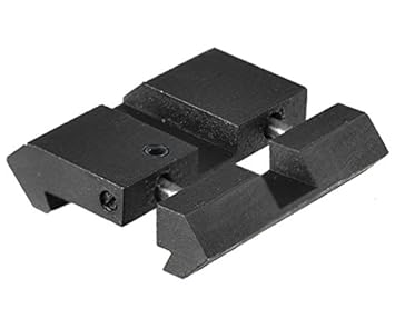

I have an adapter that goes on to the dovetail groove and then you can attach a rail
mount to that.
I used it to attach a red dot scope on to a Marlin 795.
Is that what you are looking for ?

Amazon is the place, UTG makes lots of different styles, i've used them on lots of my magnum springer air guns for years now, they hold up well. A magnum aìr gun has more recoil than a 308.....
Be aware that most of them chew up the receiver due to the tension set screws... IMO you are better off getting rings to fit the existing rail.
https://www.amazon.ca/UTG-Dovetail-...8&qid=1484448415&sr=1-1&keywords=UTG+adapters
Don't add much height and clamps solid.
I know nothing about these conversions. Just ordered one from ebay like that photo posted by Okay to experiment with.
Can you please explain how the tension set screws work that tear up the receiver? I thought when you tightened the weaver/picatiny rings onto this unit it simply tightened the conversion onto the dovetail?
Although these units are advertised to work with 3/8 grooved receivers, I do know that these conversions will not work on American 3/8" grooved receivers as they are usually rounded receivers and there is a significant difference between the angle [3/8 is 45 degree while 11mm European is 60 degree]. The only conversions I have heard of that work with 3/8 are the Weaver T-22 ones with convex curved bottoms to fit rounded receivers and I just purchased a set from a site sponsor for a project involving a 30mm tube and they are quality made units with metal claws on each side that fit into the groove like a regular Weaver tip off ring.

I have a set that I used to attach a rail mount to a Marlin 795. They are spring loaded so as the
rail gets tightened, the adapters inside the rail mount tighten on to the dovetail.
Worked fine. Then my scope went on the rail & it worked 100%.

Have the DIP rail on a 455. Took it off after a year and I can't see any marks at all from the screws. I did proactively put 1 layer of very plasticky scotch tape and torqued to spec. Great having unlimited ring options.
Enjoy your CZ.
