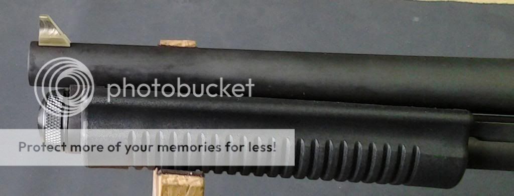

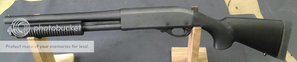

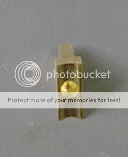

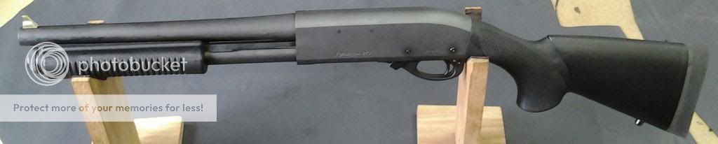

After reviewing aftermarket front sight options and finding nothing that I consider suitable, I have decided to make my own custom front sight. It really is ideal as I can sight it in and customize to the exact height I need. It also helps when you have a great machine shop with a CNC and plenty of brass bar stock :) I started making it today and when it is finished and installed I will post pictures here.
Here are a couple pictures of the sight in progress. I drilled a hole in the bottom of the sight so that the new sight can simply sit on top of the existing bead sight. The sight still requires polishing to remove tooling marks.
The sight is currently very tall as I have not shot the gun with a temporary tape sight (as suggested above thanks guys) to figure the exact height I need. I will then mill the new brass sight to the correct height. After that I need to affix and I am leaning towards JB weld as I will have to refinish the barrel if I braze it in place... still undecided though.
