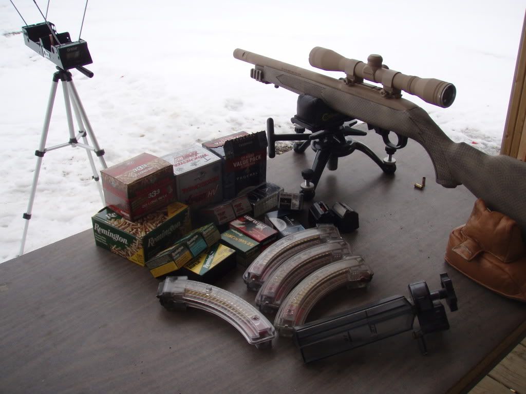

When considering a short barreled 10/22 build a month ago or so I was curious as to the effect of the shorter barrels on velocity. Some internet searching of mine ,(and others on CGN) indicated that a 16" barrel is ideal for the most common .22LR. However I was unable to find any definitive answers as to the effect on velocity the shorter barrel had.
I decided to go with a Dlask 12.5" barrel for my build and installed and Arma-Coated it as my last weekends project. Then this Friday my Volquartsen internals arrived. Installed them that night and took it to the range on Saturday along with 15 types of ammo to try and find out what this new rig had an appetite for. Just out of curiosity I brought along a factory stock (but well used) 18.5" barreled 10/22 and my chronograph.
I recorded the velocities of 15-20 rounds in the 12.5 barrel (these were used to "season" the barrel to the next ammo's bullet lube prior to accuracy testing) and 10 rounds in the 18.5 barrel then plugged the data into Excell when I got home.
Some of the results surprised me.
The 12.5 barreled rig gave higher velocities with every type of ammo that I tested. Ammo shot from the 18.5" barreled rig was from 85% to 98% that of the velocity out of the 12.5" barrel rig. No matter how I plotted it and studied the data I could find no trend as to whether high velocity or subsonic gave closer velocities. My theory prior to testing was that I would have equal (or close-to) velocities with subsonic and standard velocity rounds in the 12.5" barrel but lose some velocity with the high (and hyper) velocity rounds but this was not the case. In every type tested the 12.5" barrel gave higher velocities over the 18.5"
The Standard Deviation was much greater in the 18.5 barreled rig than the 12.5 barreled gun. The longer tube's SD averaged 37.2 FPS while the 12.5's SD averaged 19.8 FPS.
I did not test accuracy in the 18.5 barrel because that was not the scope of my testing. I was testing my 12.5 for accuracy and decided to bring the factory barreled 10/22 along for a velocity comparison.
That being said, with the shorter barrel giving more consistent velocities, in theory it should deliver better accuracy.
Please note that this is a test involving ONE 12.5" barrel and ONE 18.5" barrel so scientifically speaking the data sources are not that objective. However data from a small sample is better than no data at all.
I just thought I would share my test results in case anyone is considering a short barreled 10/22 build. From my testing you gain velocity and (theoretically could) gain accuracy.
And thats not even taking into account how handy and cool a short barreled 10/22 is.
Therefore my conclusion is that the 12.5" barrel is a win win proposition.

Yeah, ideally I would take a long barrel and do a test like the fellas at "Ballistics by the Inch" did, shoot then cut another inch off and shoot again. That would eliminate the variances that occur between barrels, even in the same batch.
Like I said, my test is just one barrel at 12.5" and another at 18.5". A true test would be the same barrel cut down and tested at one inch increments.

Yes it is the lower standard deviation observed in the 12.5 barrel that "in theory" would lend to better accuracy. I agree that higher velocity has no effect on accuracy, not sure how much a rimfire is effected by barrel harmonics, but at least in a centerfire finding the barrels "sweet spot" is more important than velocity.
As for calculating the standard deviation, I just let MS Excel do the work for me. I like it better than extreme spread values because extreme spread can be skewed by one or two bad rounds (we know rimfire ammo is prone to this) and because I had a small data pool the skewing would be even more extreme.

Okay here is the ammo that I tested and the values I obtained.
Remington 525 Golden Bullet Value Pack
12.5 barrel 1302.5 FPS Standard Deviation of 16.3 FPS
18.5 barrel 1178.8 FPS S.D. 46.7
Remington Viper
12.5 barrel 1360.8 FPS S.D. 27.4 FPS
18.5 barrel 1306.6 FPS S.D. 35.3 FPS
Remington Thunderbolt
12.5 barrel 1288.9 FPS S.D. 14.8 FPS
18.5 barrel 1103.1 FPS S.D. 85.2 FPS
Remington Subsonic
12.5 barrel 1091.2 FPS S.D. 18.6 FPS
18.5 barrel 969.4 FPS S.D. 55 FPS
Remington (ELEY) Target Rifle
12.5 barrel 1086.1 FPS S.D. 14 FPS
18.5 barrel 1047.1 FPS S.D. 14 FPS
Remington Target
12.5 barrel 1147.9 FPS S.D. 15.3 FPS
18.5 barrel 1064.5 FPS S.D. 18.2 FPS
Winchester High Velocity (40 grain lead RN)
12.5 barrel 1226.8 FPS S.D. 14.4 FPS
18.5 barrel 1180.7 FPS S.D. 18.2 FPS
Winchester Hollow Point (37 grain)
12.5 barrel 1323.1 FPS S.D. 30.5 FPS
18.5 barrel 1281.5 FPS S.D. 28.5 FPS
Winchester XPERT HV (36 grain Bulk Pack)
12.5 barrel 1291.5 FPS S.D. 18.2 FPS
18.5 barrel 1264.4 FPS S.D. 21.1 FPS
Winchester 333 (Plated 36 grain Bulk Pack)
12.5 barrel 1300.7 FPS S.D. 21.1 FPS
18.5 barrel 1268.2 FPS S.D. 16.6 FPS
Federal Game Shok (38 Grain plated HP)
12.5 barrel 1266.3 FPS S.D. 17.2 FPS
18.5 barrel 1209.5 FPS S.D. 34.8 FPS
Federal 40 grain solid
12.5 barrel 1286.6 FPS S.D. 13.7 FPS
18.5 barrel 1265.4 FPS S.D. 9.8 FPS
Federal American Eagle (40 grain solid which I suspect is same as above but different package)
12.5 barrel 1276.1 FPS S.D. 19.2 FPS
18.5 barrel 1231.7 FPS S.D. 23.8 FPS
Federal 525 Value Pack (36 Grain plated HP)
12.5 barrel 1254.1 FPS S.D. 21.1 FPS
18.5 barrel 1195.7 FPS S.D. 28.0 FPS
CCI Velocitor
12.5 barrel 1348.3 FPS S.D. 35.4 FPS
18.5 barrel 1177.9 FPS S.D. 86.8 FPS
And there you have it folks.
The most accurate, and consistent, was the Remington (ELEY target rifle) ammo. If I do any target shoots that will be my go to ammo. I now know why Andrew of Canadian Reload Radio prefers ELEY for his silhouette competition.
For a gopher hunting round I think I will go with the Winchester bulk pack offerings, I really like the large hollow point on thier bulk bullets. Hope to anchor the gophers a little bit better.
Some have said that Dlask chambered thier barrels to work best with the bulk ammo choices and I found that my barrel tended to do just that. Decent accuracy with Remington, Federal and Winchester offerings, which is great. What ever is on sale or in stock I will buy and be happy to shoot.
