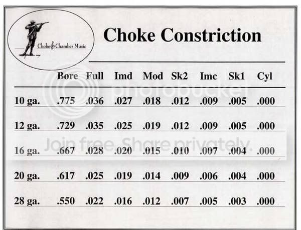

What I need is the diameter of a full choke, improved cylinder and no choke.

A lead slug would still compress sufficiently to exit even a full choke....what that may do to the accuracy is a different question due to so many variables. Anyway, here is a chart that you could consult....the calculation shown are in inches.
