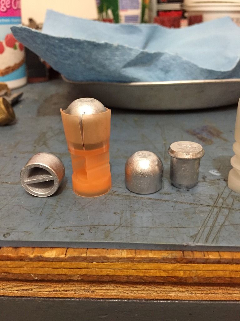

I chose the yellow wad as it had the thickest petal out of all my wads. I trimmed the petals down by clipping 1/4" off.
And the Federal 20S1 I completely cut the entire wad column off so i just had the base.
So it was 20S1 first then felt wad then 1oz slug; (the petals aren't clipped in the pic)
I then placed this load on top of 18.5 grs of the Titegroup powder and fully crimped.

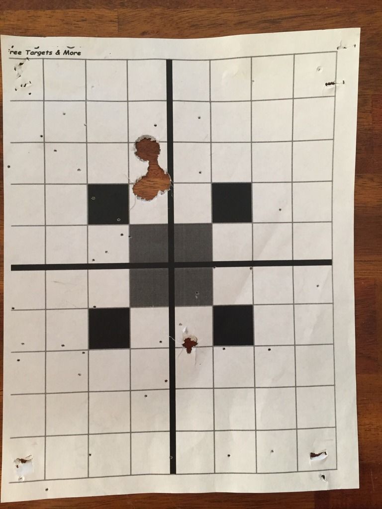

So my target was placed at 33 paces from the shooting bench. My first 3 shots produced this group;
I did have other loads using Green dot and 800X but they didn't group quite like this. At 50yds the group opened up 1" No biggie.

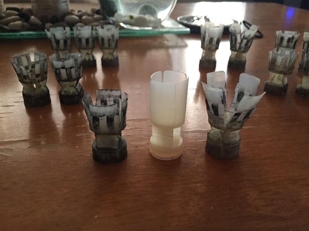

My recovered wads. You can see even though one batch weren't clipped shorter they still opened up well. They did however not group as well as the ones that were. They did group well mind you ;) Not all holes were touching lol

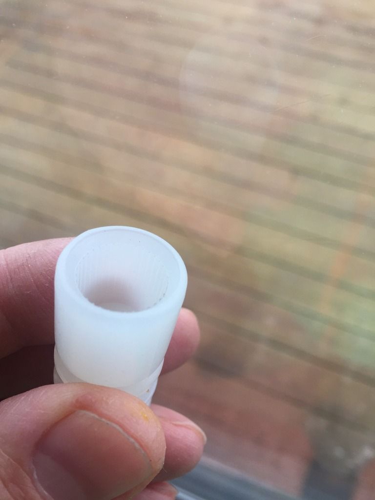

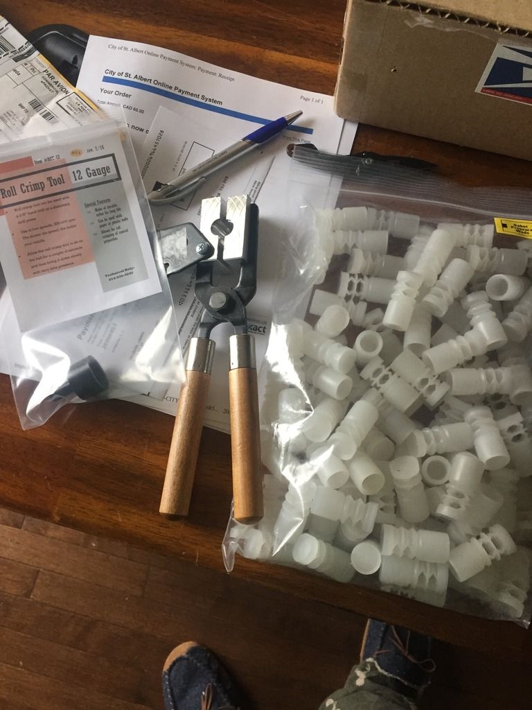

They have a Lee mold to cast your own HH slugs but the kicker is they require their wad, the SPW or Sabot Pressure Wad. These are a very sturdy/rigid plastic wad with a splined column;

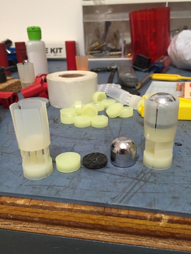

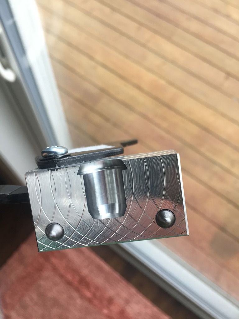

HH (Lee) slug mold from Slugs R Us.
SPW

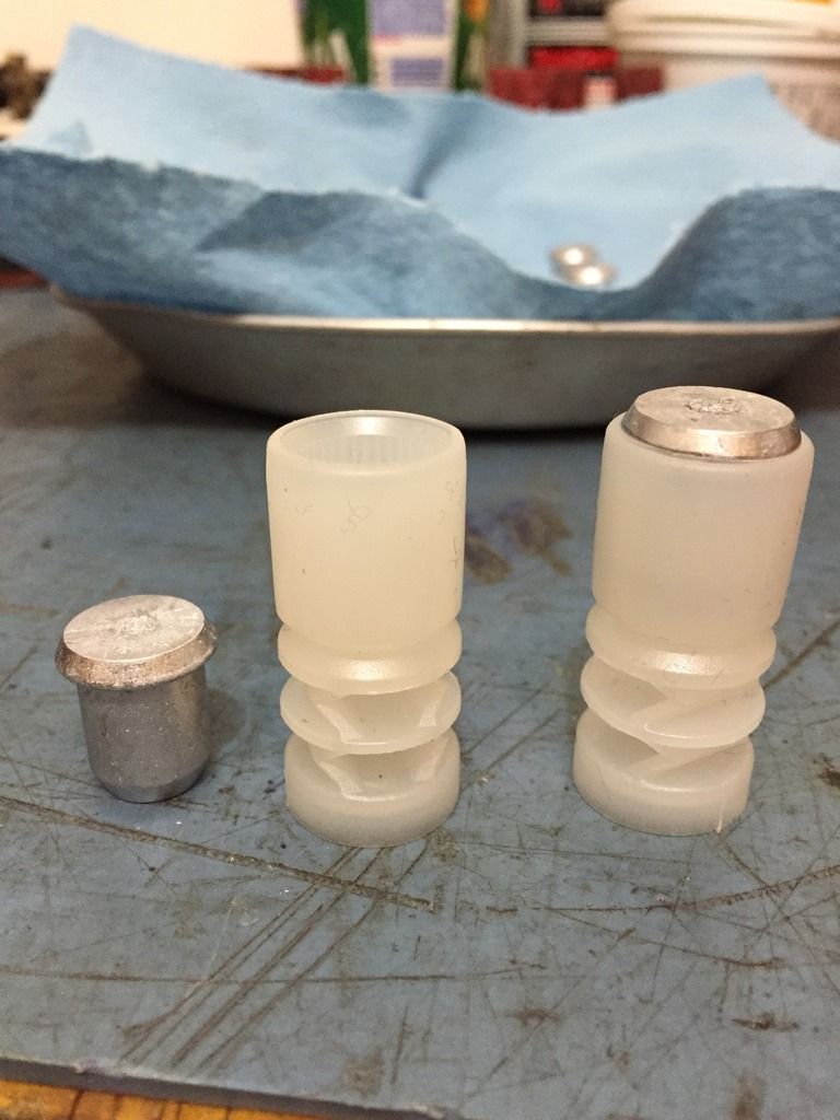

Hammerhead shown next to Lee Drive key

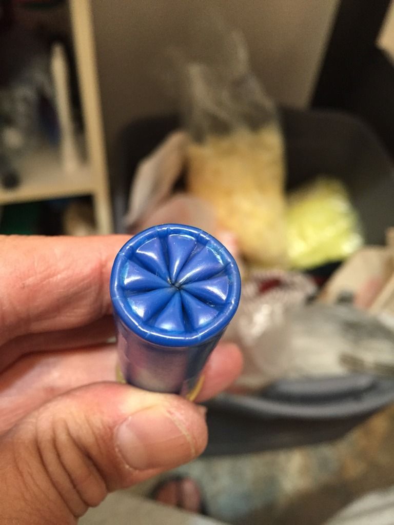

And finished product. A roll crimp is recommended for the HH slug. Which I ordered as well;

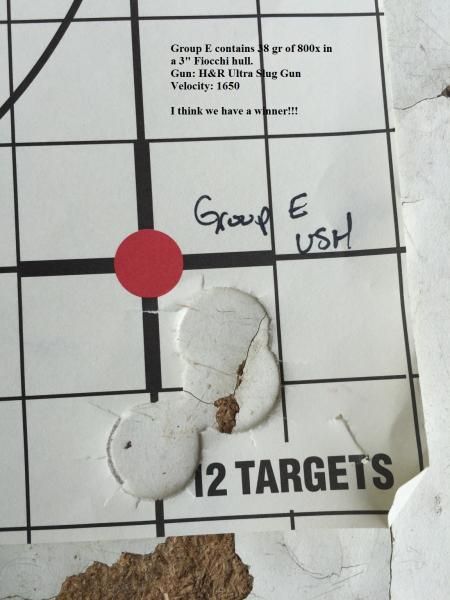

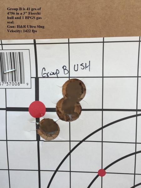

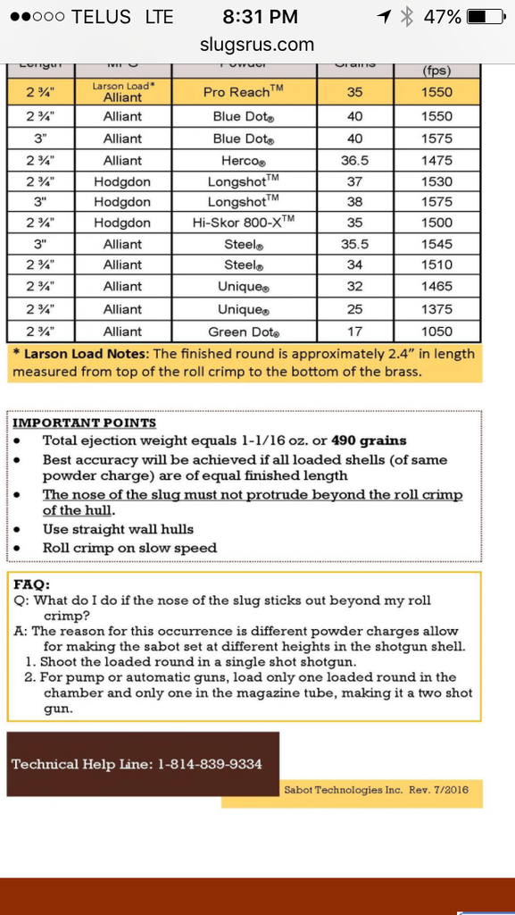

Unfortunately I won't get to the range anytime soon to test these out but this is what I hope to achieve as posted by another castboolit shooter. All shot @100yds;
If anyone remembers Hasting sabot slugs and rifled barrels, these HH slugs are a similar design;

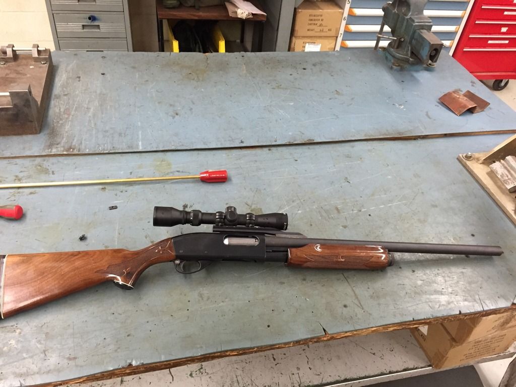

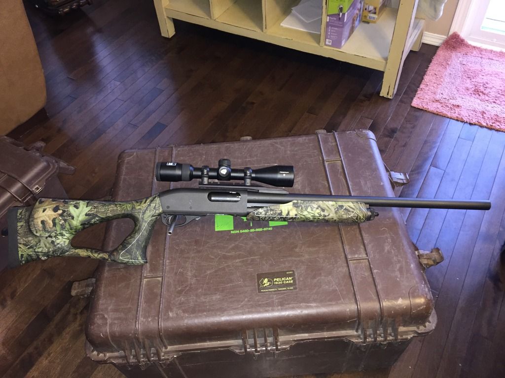

And here is the new Rem 870 I'm shooting. Same barrel;

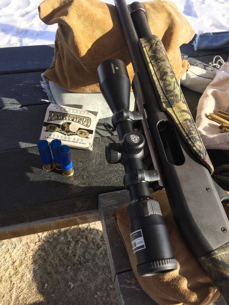

Shot really nice at the range. Here in this pic I'm trying out some 2 3/4" Lightfield Hybrid sabot slugs. I also tried some 3" Lightfields but they were way too painful!! Not fun at all to shoot.
The 2 3/4 were amazingly accurate at 50 & 100yds!! But at $20/5 :O. I'd much prefer to roll my own ;)
Thanx, guys. You just phoqued me up!!!!! I was utterly disgusted with paying $4/slug for sabot slugs. Now, reading this [hoquing thread, you got me interested. Seeing as I have molds for 44 mag 250 gr. RN and 50 cal Maxi's, I just ordered 20 of the wads for 20 and 12 gauge, and the roll crimp tools for each. Thanks a lot. Friends, my butt!!!! I'll end up in the poor house!
Now, what are you using for loads in the 20 and 12?

If you read above ^ and see what I loaded and how I assembled my slug pic#1, then look at the results of my 3 shot group @33 paces,pic #2, you'll see that I was able overcome my frustrations of 2006 with the Lee Drive Key slug and found a golden Load that puts damn near 3 Drive key slugs touching at 50 yds
The data that Lee provides might be a good start but imho the speed of 1500 fps is too fast for the thin WAA wad and causes the petals to rip off thus defeating any wanted accuracy. My load with Titegroup powder is approx 1200-1300 fps ( no chrony).
