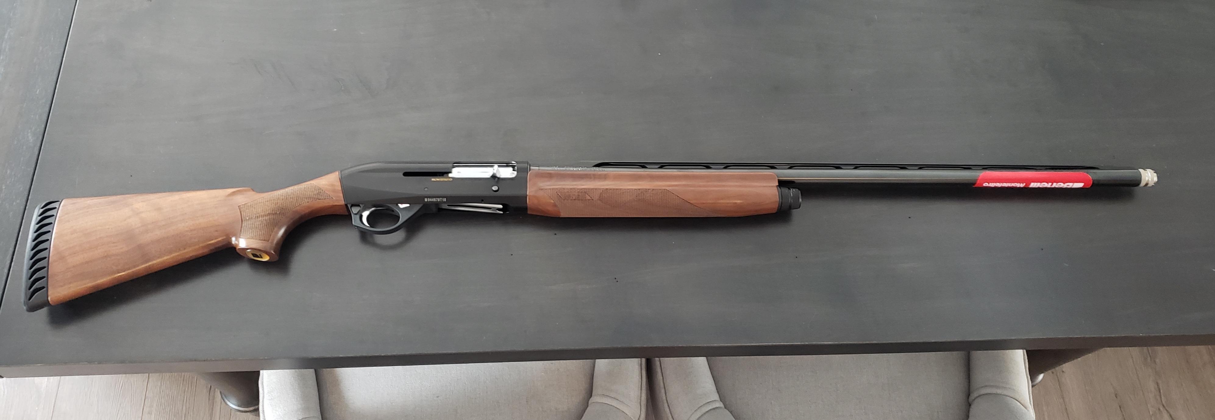

This is alll good info. I have been looking for an old beretta like the 390s but have not had any luck lately. I ended up ordering a benelli montefeltro sporting 12/30 today as I dont want to miss anymore trap days! Should have it by the end of the week.
