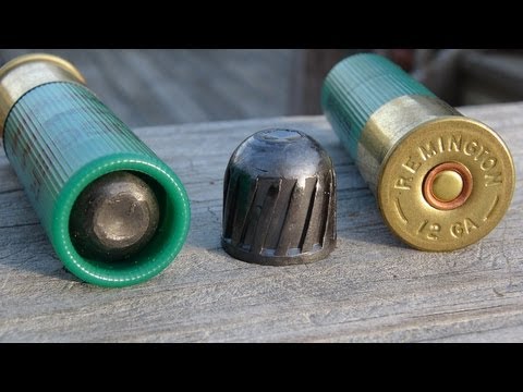

I bought a box of 2 3/4 remington sluggers, are those like a "round ball"? They aren't rifled.
Remington sluggers are your typical "Foster" type all lead slug, not a round ball like Dominion. Think of Foster slug like a badmington shuttlecock. Upon firing, they flare somewhat to the bore of the barrel and the diagonal striations allow the slug to swage through various chokes, but act nothing like sabot slugs which require a rifled barrel and spin like a bullet to stabilize.

The Remington slugs do look like round balls from the front. It's a dome-shaped slug with straight, "rifled" sides and is hollow. Without cutting the shell open it can be hard to tell though.
I found this pic showing a loose Remington slug removed from the hull:
