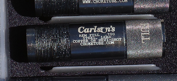

I have an extended 12ga Full Remchoke from Carlson and another one from Trulock, and both are marked as 0.700.
However, my online research leads me to believe that a Remington's 12ga Full choke is 0.687 .... ?
(see table below)
So, I am wondering .... has anybody an authoritative source of what the inside diameter of genuine Remington Remchokes are?
I mean 0.700 and 0.687 is a big difference .... like the difference between a Modified and a Full.
So what is it?

Ok, I ordered a digital caliper .... and it arrived today.
My Remington "Remchoke" flush Improved Cylinder choke measured .716
And I have two Remington "Remchoke" flush Full chokes here ... one measured .686 and the other measured .687
(All those chokes were bought new around 6 years ago.)
I guess I have my answer ... that table in my first post seems to be correct.
And now I understand why there is such a big difference in patterns between my original Remington Full and the Carlson and Trulock Full chokes ....
The Carlson and Trulock Full chokes .... are basically Modified chokes .... :-(
