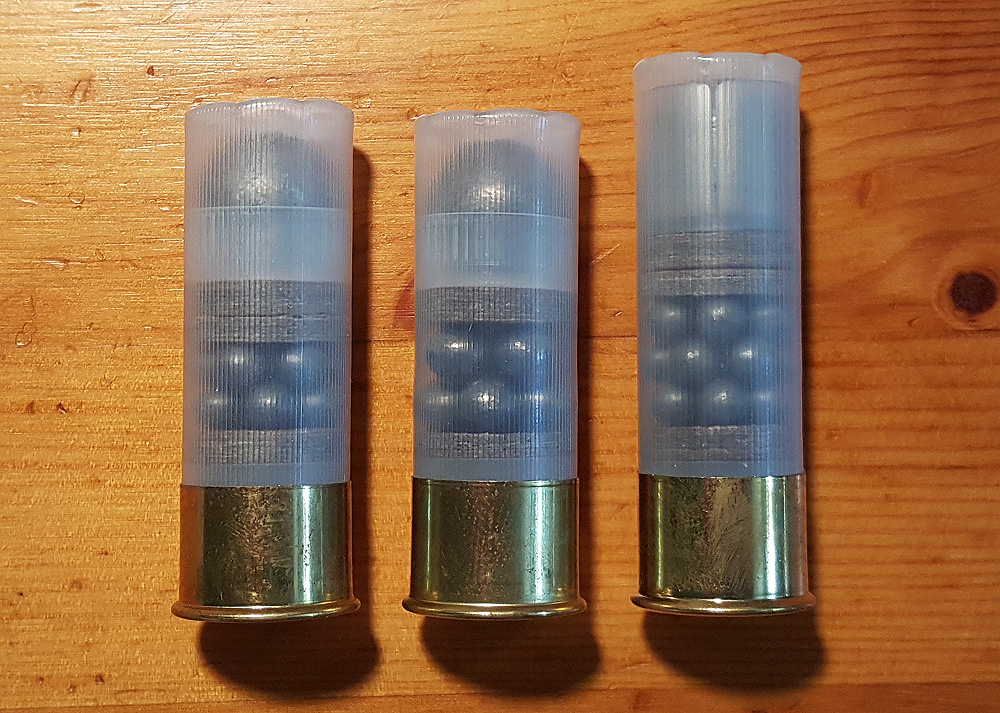

For black powder 10 gauge using all brass hulls, I first glued three .375 round ball into a triangle then glued .495 round ball on top. I then used Circle Fly nine gauge fiber wads and cards, propelled by 85 grains FF Goex.
I used a roll of heavy magazine subscription paper to keep this improvised slug centered in the 2 7/8 hull.
Clear silicone to glue in the last over shot card.
So far shoots like a slug gun at 18 yards from full choke barrels, my Parkhurst coach gun. So far no signs of tipping or seperation on the target paper. But I am kind of skeptical one can pull this off with the higher pressures of smokeless powder. I have never tried this because I have no need for it.
I had Nick Makinson give this shotgun a going over to ensure its safe to shoot. Also this older gun has plenty of meat in the chamber area. It's kind of a beast at 10 1/4 pounds with its original 20 inch barrels.
These look interesting. I would like to try that load, but instead of the wad separating the 2 payloads, use wax to make a wax slug of the entire load. It would hit and then become a buck and ball.
Ganderite, give it a try ... and let us know how it went.
From my research my gut tells me that wax alone will not be strong enough to "glue" the whole load together into one slug.
You might need to enclose the whole load into a wad and to keep the load together during flight. But I have no proof of this ....so I am looking forward to your results.
I am wondering .. if you manage to create a sort of frangible slug, why do you need the round ball? A load comprised of #4 or #1 buckshot .... glued together by wax into a slug ....should be able to kill anything on this continent ... no?
It would behave similar to this .....just with more penetration .....or at least that is what I would assume.....
https://www.canadiangunnutz.com/forum/showthread.php/1635960-Unofficial-12ga-Slug-Penetration-Comparison?p=15046117&viewfull=1#post15046117
