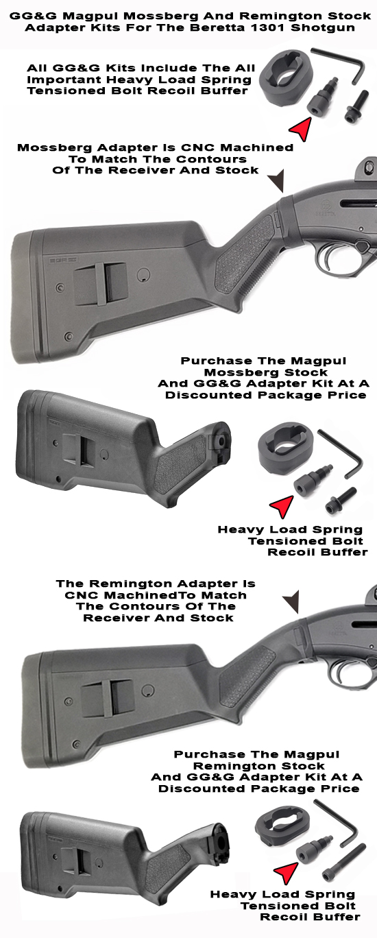

My Comp Pro LOP is just a little bit long for me, thinking of replacing the stock, 2 options I seeing, either GG&G and Aridus Adaptor and Magpul Rem or Mossy stock, haven’t handled or seen either one, whats your recommendations for Adaptor and stock, would prefer 13-13.5” Lop and 2” drop from comb. The comp pro stock is nice , its just doesn’t fit , even bought the thinnest of the beretta gel pad.

Curious mind wants to know: Is the LOP the same with either adapters?
I can speak for the ggg/ Mossberg Lop is around 12 3/4. Heard the Aridus is 1/4 slimmer, but can’t confirm. Also heard that both ggg mossy and 870 adapter has the same thickness

Already removed the spacer from factory and installed the thinnest pad.39”, still long for me. The magpull stock has a good LOP, but the adapter in my gun GGnG doesn’t have enough drop for the stock, so the butt still rides a little high on my shoulder.
